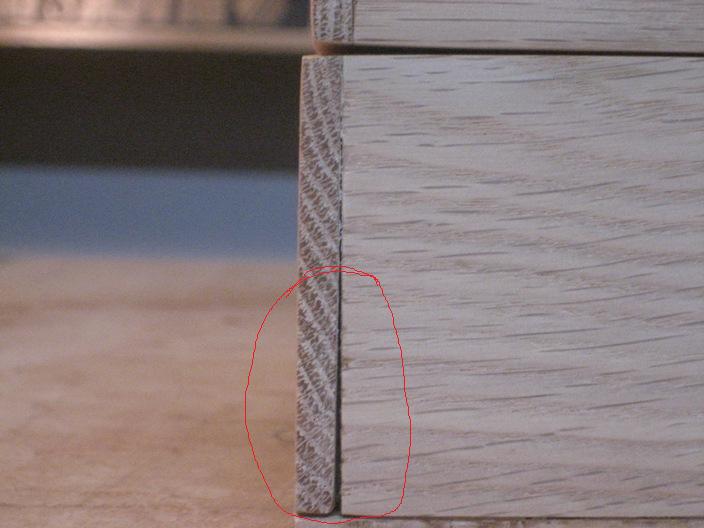

                Here is the offending gap circled in red.
                As seen here in this photo the rest of the joint fits fine, and on the bottom, which is now covered by the bottom panel, there is only the gap on the side with the rest of the joint good and solid.

                  Looks almost small enough to feed in some glue and clamp it closed.
                    To give a sense of scale, the end grain side you see is 1/4 inch thick. The box is built with 1/2 thick red oak.
                      As others have written, you're not going to get a perfecet match, no matter what you do. Using the sawdust mixed with glue or shellac (I haven't tried the shellac idea - interesting!) will fill the gap, but be near impossible to match color. Having all that end grain showing will make the whole problem less of an issue. You're going to have a mis-match between the end grain and the long grain - the repair will probably look a lot like the end grain.
                      Having said all that, my suggestion is to NOT stain first (sorry woodturner ). Start with a sealer - shellac or the Minwax Pre-Stain compatible with your stain/top-coat materials, or whichever compatible sealer you like. Then apply the stain. This has the benefit of sealing all fibers, so that when the stain goes on it will look more uniform throughout the project.
                      I learned this technique from a pro re-finisher who gave a class to my local club. There were a million tips in that class, but the seal first technique was one he emphsasized quite emphatically.

                          Is the inside of the joint tight? If not, cabinetman's suggestion of applying more glue & clamping it closed might work. If the inside is tight, clamping won't help.
                          You might consider trying to cut the joint line & glue in a thin piece of stock. It might be a trick to get a piece with grain matching (pattern & direction), although it might be thin enough to not show very much (?). I've seen it used before in fixing different joints, maybe you can make it work here.
                            If it is tight, striking a cut line (to the rabbet) to allow for the movement can be done with an X-Acto knife and a thin straightedge.
