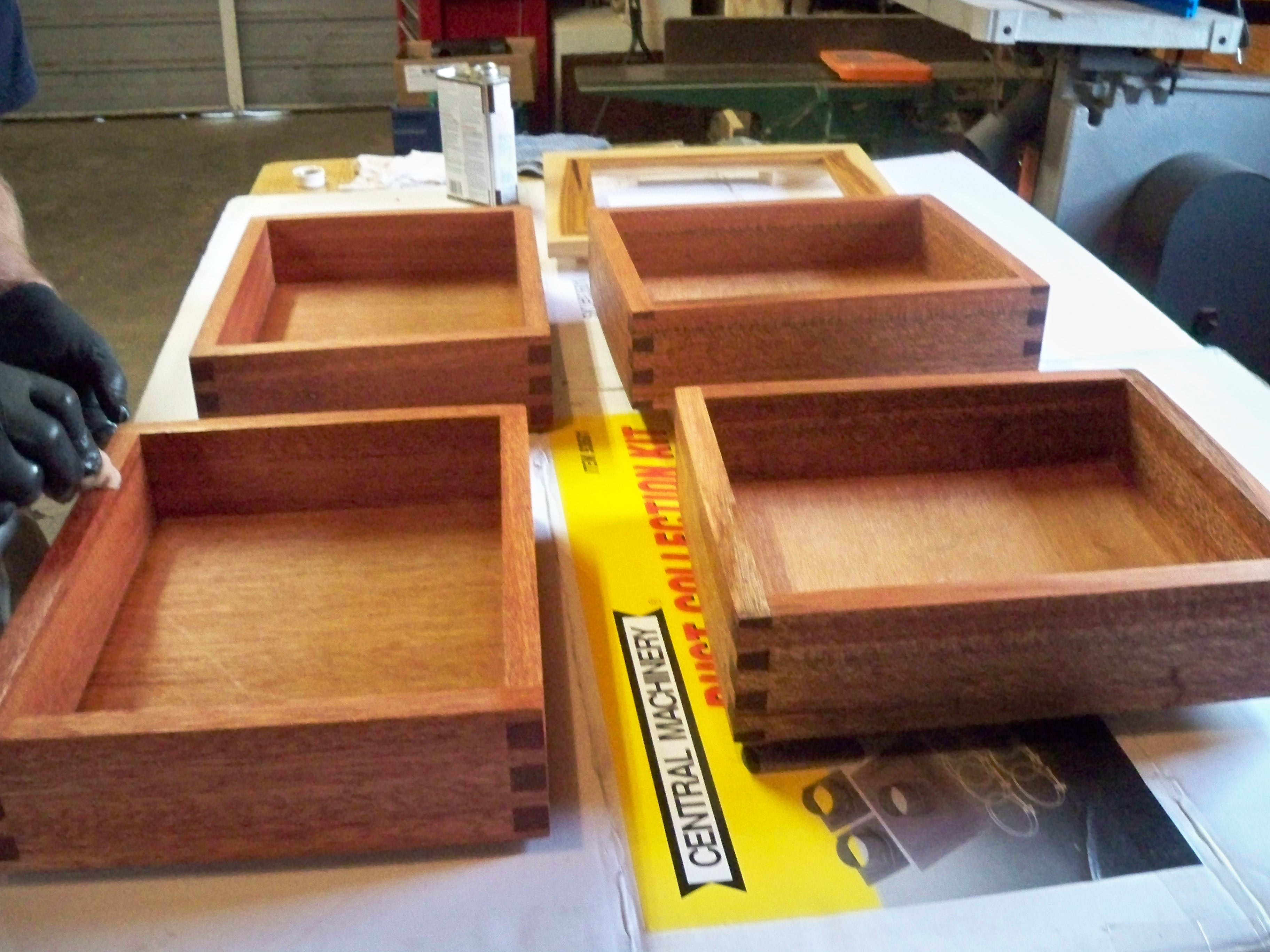

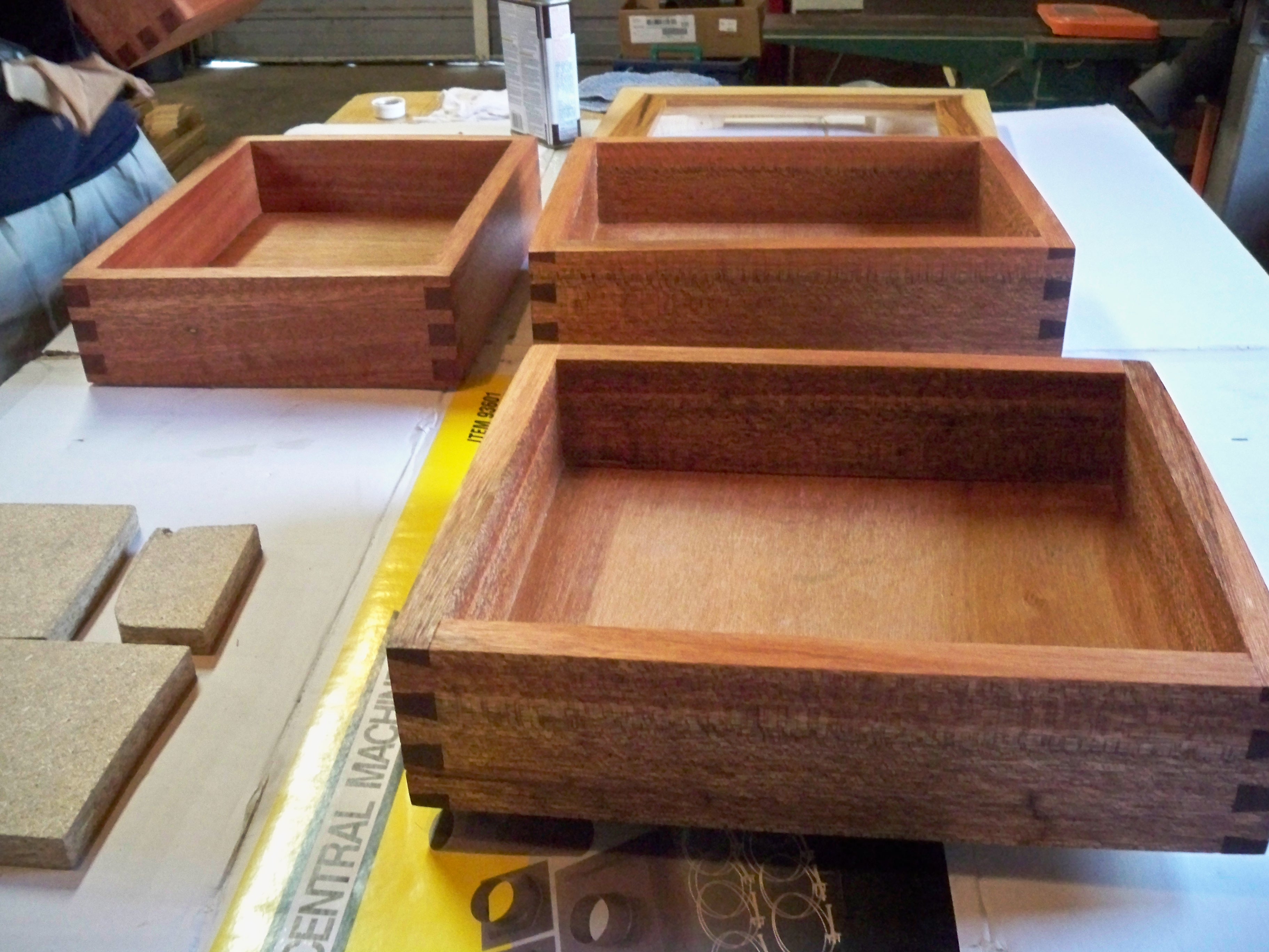

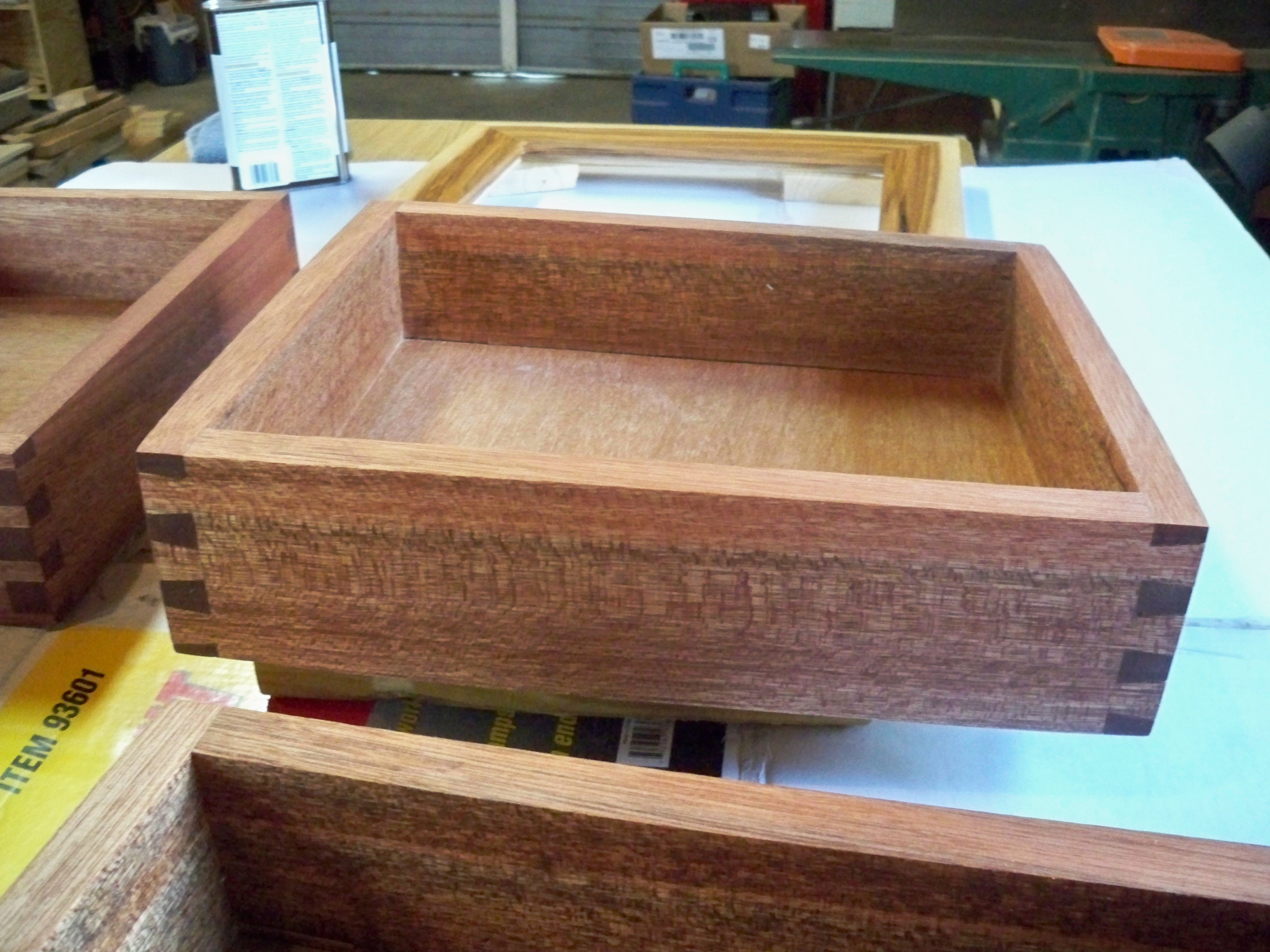

              We like what we see so far. Green or dark brown felt will line the bottoms. Using Watco Danish Oil, natural color. This is the second coat going on. Sanded with 60, 80, 100, 150, 220 grit--and then 1500 grit between coats. First time trying this kind of thing--made a lot of sawdust, but no scrap!!
              earl
