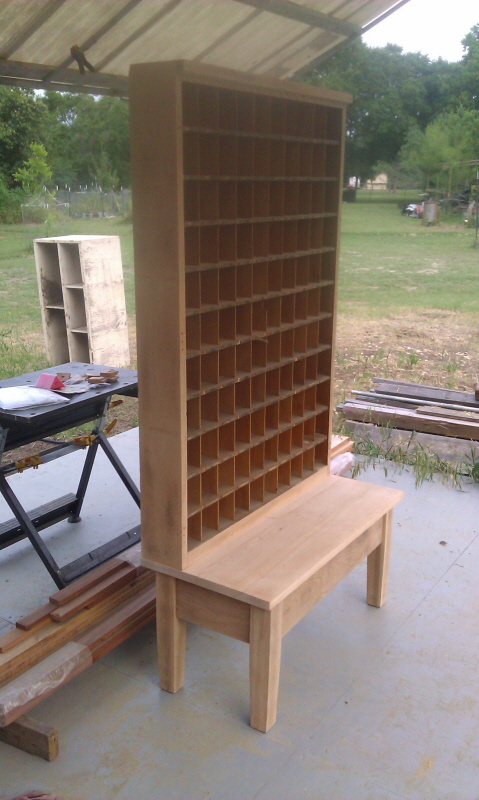

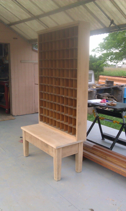

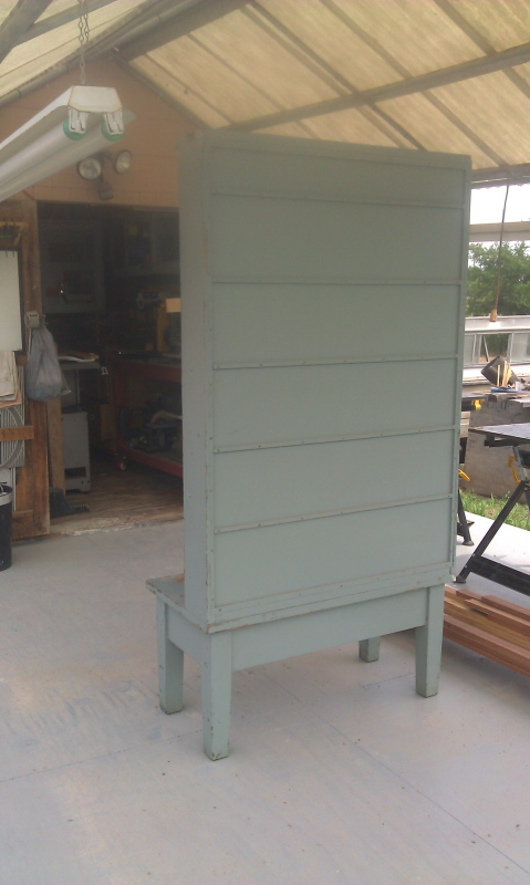

    Last week I talked the Austin Postmaster into letting me have an old sorting bin for $25 rather than it going to auction. I brought it home Saturday.
    There are 110 (11 high and 10 wide) bins.

Name:	Sorting Bin 3.jpg

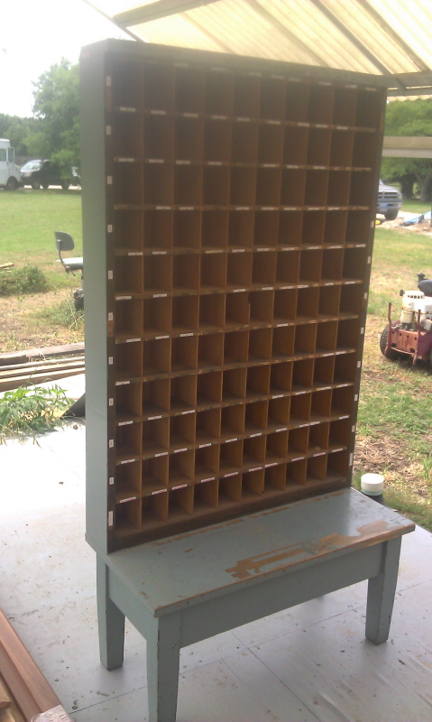

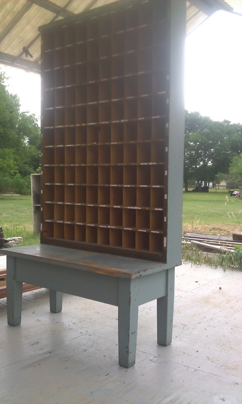

    Sunday I took time off from yard work and spent the day disassembling and sanding to see what was under the paint.

    The top of the base is Maple. The rest of the base and the case frame is White Oak. The outside frame of the upper cabinet is dovetailed together.
    I still have to pull the back and clean the paint off it. Once the back is off, I will see if the dividers come out easily for stripping/sanding. If not, I will stain the parts I sanded down to match the original stain and then finish with precat laquer.
    I am going to make slide in boxes for each bin and give it to my wife for her sewing/craft room. My original intent was to use it for a parts bin in the shop, but it is just too nice a piece to put in the shop.

              What did you use to strip the paint?
                I think I got a steal, too, especially after I the paint started coming off to reveal the White Oak and quality construction. I had 2 problems with it going to auction. First, it would have likely been offered as part of a lot of other items. Second, the auctions are held on a weekday when I am working.
                Tim, it probably won't be finished by Mother's Day. With a little luck I will get the cabinet ready, but not the boxes.
                Joe, the stripping was done with a ROS and 80 grit paper, still a lot af sanding time to go.
                Including breakdown and loose reasembly of the base I spent about about 5 hours in the shop. That included doing some repairs. The Maple top had cracked along one of the joints and had to be cleaned up and reglued. Also, I had to remove the lip at the top of the cabinet and the brass label holders for the top row of bins. Amazingly, all 110 of the label holders are still there with only some minor, reparable damage to a few.
