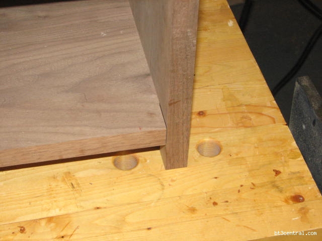

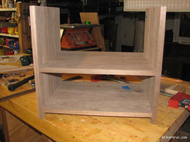

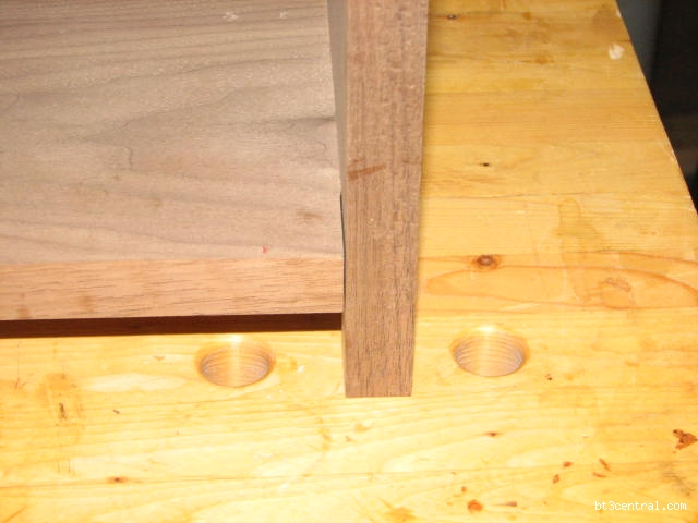

                    An update on my project that got derailed by life. It is now going to be a Christmas present so it's getting down to crunch time. I have all the panels glued up and sized. I'm fairly happy with the results so far. I cut the stopped dado for the 2 shelves. Despite my care in glue up and flattening, it appears the side panels developed a very very slight twist. This i causing the bottom shelf to have less than a 1/32" gap. I am thinking that will close up when i glue and clamp. Would this be a correct assumption? If not, what is the best solution? Am i being too picky?
                      It looks good. The gaps may close or they may not. You might try shaving a smidgen off each end of the shelves so they do not bottom in the dadoes if you've not already glued them. If after assembly you have a gap cut some thin strips of the same lumber, coat them with yellow glue and inset them in the gap. let dry and then trim flush with a very sharp chisel. I have used this method on more than one occasion to fix board that seemed to shorten during assembly.
                        I would clamp it and see. Assembling "dry",without glue is a good idea anyway.
                          +1. That will tell you. If the gap doesn't close up take Mark's suggestion to take a small amount off the edge of the shelf until the gap will close on another test clamp up. Make sure there are no other obstructions in the fit.
                          • Zbart
                            • 24
                            • Lansing, MI
                            It does close up when i clamp it. The issue appears to be that because of the slight twist of the side, when i seat the shelf in the dado and square everything up, it pulls away and makes the gap. A medium amount of pressure by hand gets it to close up so it appears that the shelf is not bottoming out in the dado.
