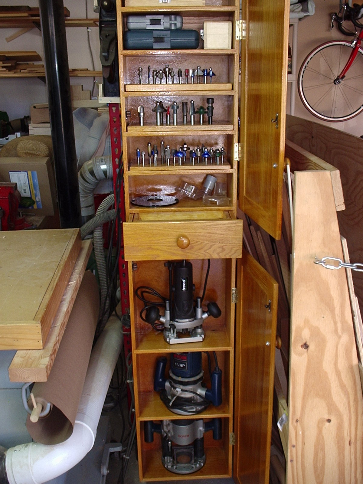

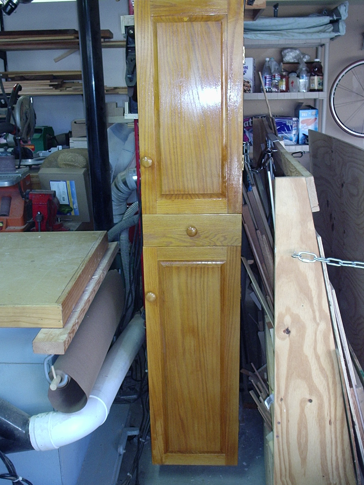

                  Beaux Ti, I hope these pics will help move your project along. This is a cabinet built a couiple of weeks ago to hold my router stuff. It's made of 1/2" oak, but the joinery might be useful for your 3/4" plywood project.
                  The cabinet is mounted on a post. The location is a step away from my BT-mounted router table. It's intended to hold all my bits, accessories, bases, tools, etc.

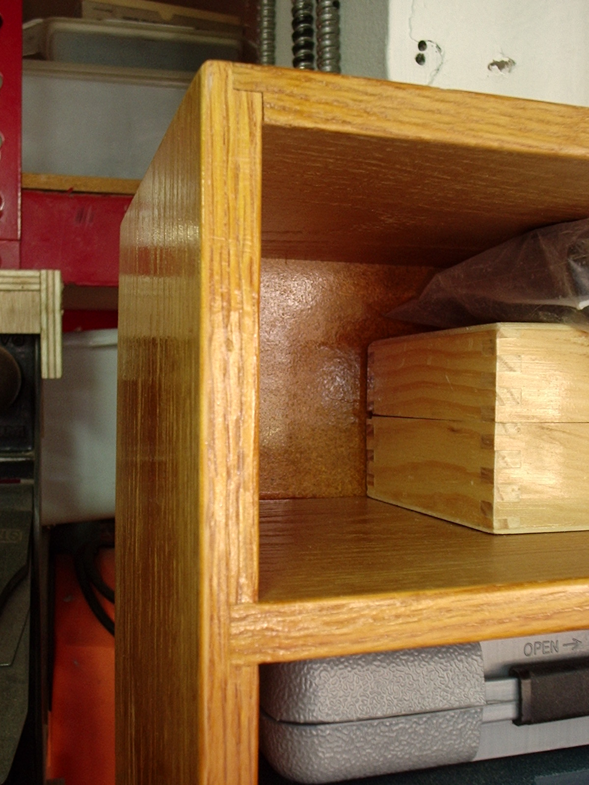

                  Since it's designed for my collection of router stuff I elected to make the shelves fixed in dadoes at specific intervals. Alternatively one could use one fixed shelf to aid in stiffness of the assembly, with the others set on shelf pins for flexibility in locating them as the needs change. The assembly is fixed to the post with cleats inside the case, screwed through the back panel into the post. I didn't use french cleats because I wanted to use as little depth as possible. I don't mind losing a little usable space inside the cabinet in this application. The back is 1/4" hardboard (not the best choice, but I had it in stock), let into a 1/4" rabbet in the back.
Name:	Router cab open.jpg
                  I used simple dadoes in the sides to fit the shelves. I've rabetted both the sides and the top and bottom pieces where they are joined. For your playwood construction I'd suggest a simple rabbet in the sides - plywood tends to fall apart a bit when making narrow rabbets. I used "a few brads to hold it together until the glue dries" on the corners and the back.

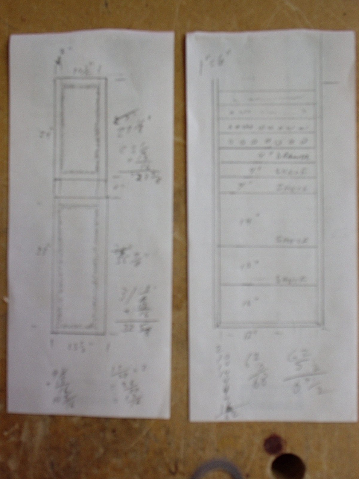

                  Here's the plan I made. It didn't require a whole lot of thinking and it evolved as the wood got cut. For instance, the exact depth was determined by the width of the wood I was able to find. Also, if you can see it this fuzzy picture, you'll see that the drawer changed locations as I mulled it over. The only really important thing to remember is that you want the dadoes and rabbets on the facing pieces to be cut at the same time, in the same way, to assure symmetry.

                  It's woth noting (confessing, really) that this was my first attempt at raised panel doors. I learned a valuable lesson - don't put biscuits near the ends of a glued up panel or you run the risk of exposing them when the pane is raised. The flaws are there as reminder in future projects!
                  I guess I should also note that I broke out the spray gun for the first time to apply teh shellac. Oh, man, was that an entertaining exercise!

                    Nice work!!! You are way over my head. really like the bit trays - do the slide? Also - I have to ask about the spray ;-) .. I have an Air brush that I just can not seem to get the hang of , although it has improved my cleaning skills.
                    Beaux Ti -
                    If you see a Bomb Tech running, follow him....
                      This is not complicated stuff. It's the very basics of woodworking. You CAN do it, and you'll find that it's pretty easy. Dive in, the water's fine.
                      The bit trays are just boards with holes in them. They just lift out of the cabinet. Same with the drawer; it just slides out.
