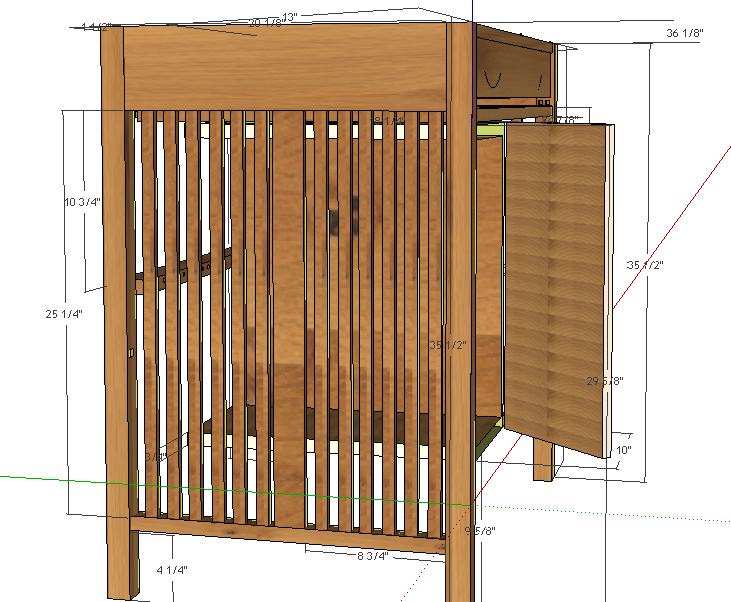

    How do I make this cut(s)?
    I don't have a planer or a jointer.
    I am building a table which has a number of slats on both sides. I have cut the slats (1" wide each) by re-sawing 1" thick wood, so the thickness of each slat is approx 3/8 to 1/2" (my re-sawing was far from exact). I really don't care about how it looks (and the variation is not really visible to the eye), but since I am thinking stub M&T to fit them to the apron/stretchers, I will need accuracy when cutting the tenons on them. Basically I have to worry about the wood left behind (1/4")and not how much is removed in the cut. So what is the best way of achieving this?
    I am thinking tenon dimensions 3/4" wide, 1/4" thick, and 1/2" tall.
    I thought this
    a. First tenon cheek - trim one side of slat (removing maybe 1/16"). Maybe use the router-table for this?
    b. the opposite cheek - use the TS? which would mean trap the slat between the blade and a sacrificial fence exactly 1/4" away? I guess I will have to think up a jig to hold the slat firmly and not allow binding. Again, the variation in the slat thickness makes that jig dicey.
    Any other ideas or suggestions?

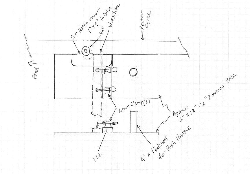

              universal store-bought coping sleds are nice. But you can make a special purpose DIY one very easily.
              Here's a sketch of one you can make in about 20 minutes.
              You'll need a couple of lever hold down clamps like these:
              In use align the workpiece end even with the edge of the jig. Easy way to do this is to place the jig edge against the fence and clamp the workpiece into place flush to the fence. place the jig against the router fence with the spinning bit in the opening. feed to the left holding the handle and the front of the jig to keep the jig to the fence. Let the bit cut into the backing piece to prevent tearout. You may want to make more than one pass taking shallower cuts! e.g. the jig not flush to the fence for the first few passes.
              The bit should be adjusted so that the cut depth is as you want it. The bit i recommended had a bearing stop at 3/8", you can set this so the bearing is even with the router fence (use a straightedge) to make a precise 3/8" tenon.

                Excellent description and diagram, Loring!
                I believe I have one or two of those clamps in my 'shop. Should be interesting.
                Thanks for taking the trouble and time!
