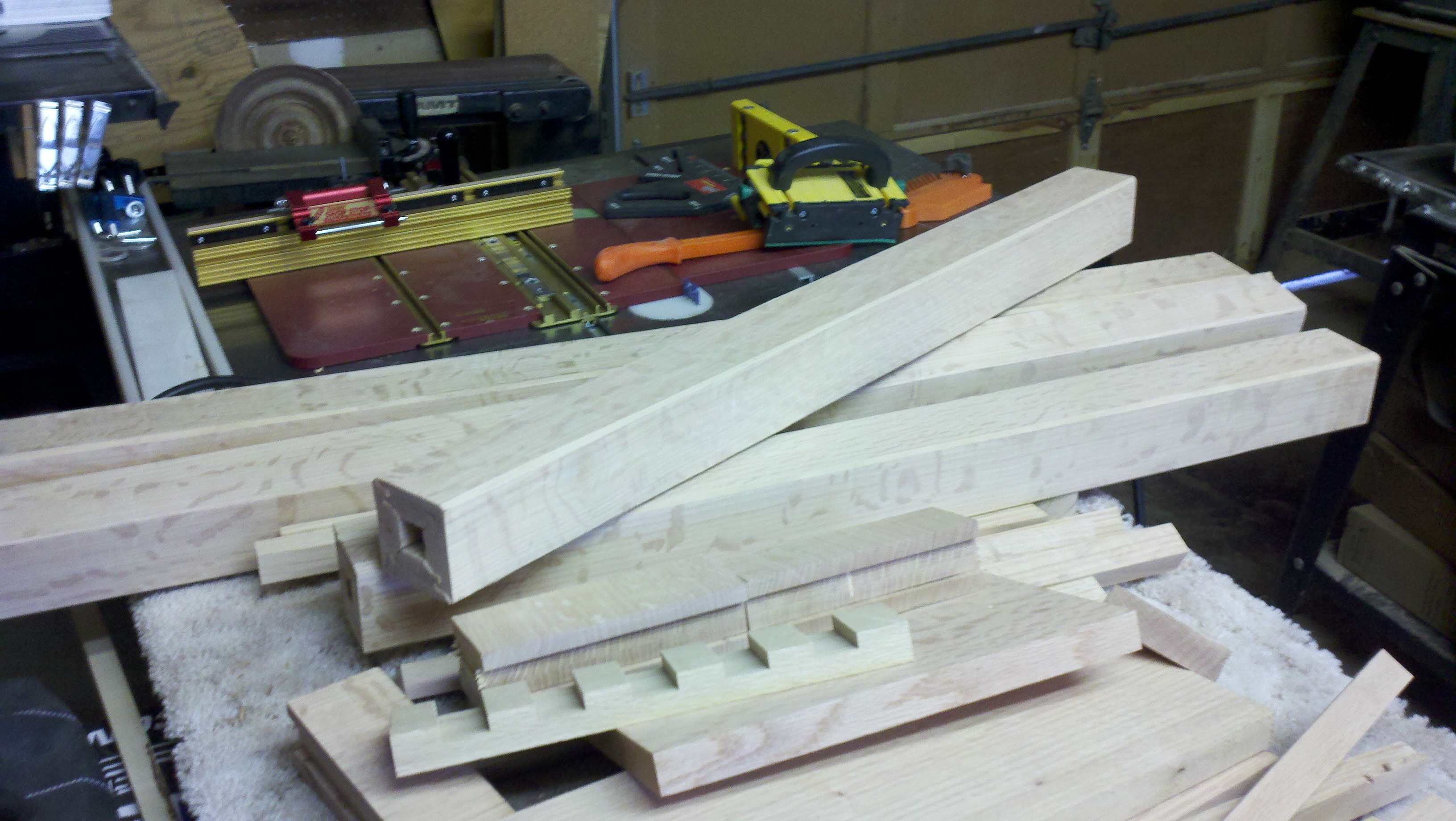

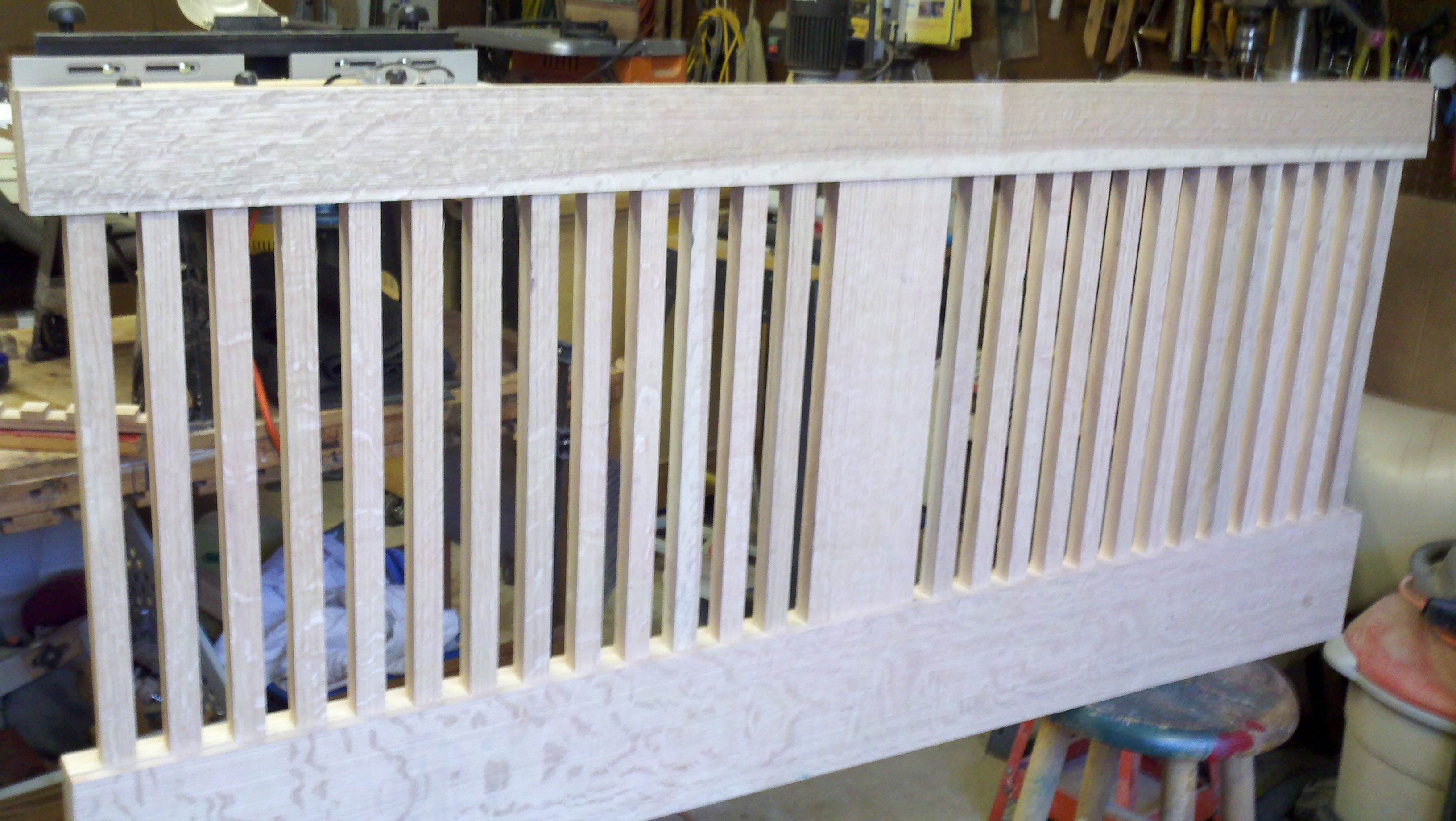

    I finally got moving on this project a month or so ago and made a trip to Huntsville, Texas and the M&G sawmill and picked up about 120bf of exquisite rough cut QSRO. After several hours of cutting rough lengths, jointing edges and planing and then several more hours of shop time cutting "pieces parts" ... I have a little progress to share ... all of the pieces are cut at this point ...

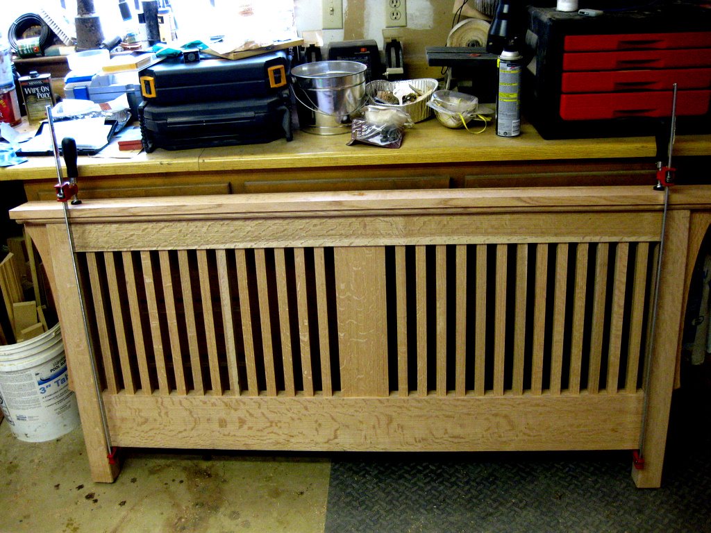

    This photo shows the footboard dry fit to see if everything lines up ... getting all those spindles in all those square holes is no small task!!

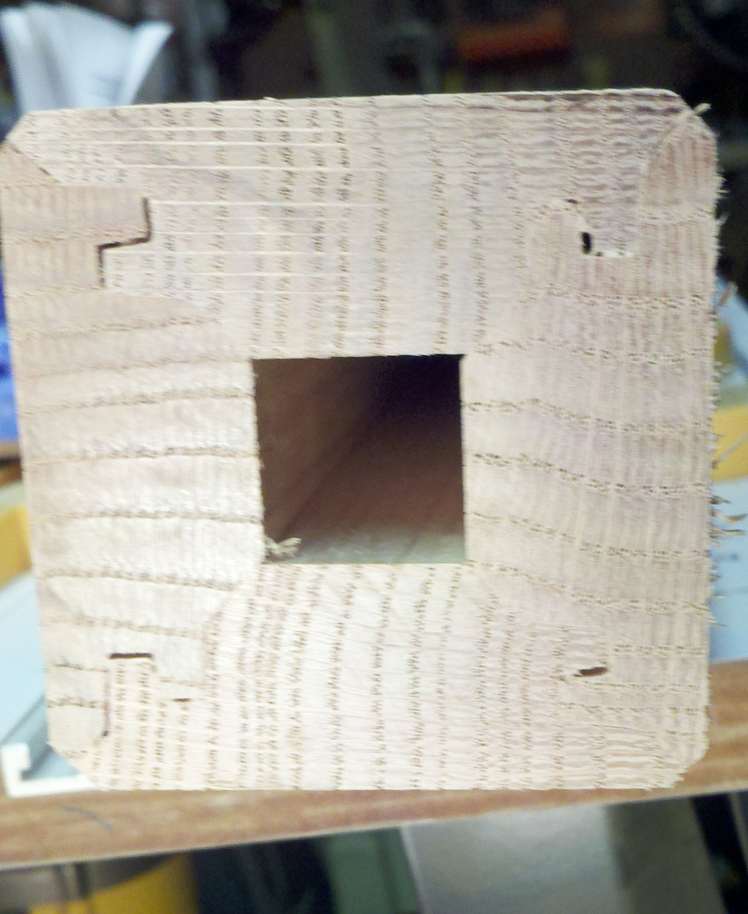

    and this photo shows the legs finally assembled ... I used a lock miter bit ... it WAS difficult to get setup and a scary thing screaming on the router ... I took 4 passes on each edge to get the full cut ... so for all 4 legs a total of 128 passes on the router table ... it was a bit nerve wracking but I am happy with the result ...

    Much more to do but getting close to putting all the pieces parts together and then trying to get the color to suit the "customer" ...

      How was using the Miter lock bit?
      I'd thought about trying a miter lock bit, but it looked scary and the setup painstaking. Both vertical height and horizontal bit exposure from the fence need to be adjusted perfectly. With the vertical cut you will end up with the piece riding on a knife edge. So I never got one.
      Was the results worth the work???
      How about a closeup pic of the end of the legs?
      Any pics during the cutting?

        Lock Miter
        Man you guys are tough!! I said I was "happy with the result" ... not that the result was "perfect"
        Here's a shot of one of the ends ...
        As is evident in this shot I chamfered the edges a bit because as LCHIEN indicates you wind up running on a feather edge of the wood and it just doesn't 'survive' all that well ... I read that an option to that is to cut the work pieces just a little oversize and then sand or plane them down to final sizing but I decided a little chamfer on these wouldn't look bad.
        (in my pathetic defense ... my router table depends solely on my ability to adjust the router height "with the router itself" (DW-618) no fancy lift mechanism ... had I had a good quality lift I think I could have dialed it in virtually perfect with some patience ... it took me about an hour of 'tests' before I was satisfied enough to attack the actual work pieces)

          • 22098
          well, that looks pretty good actually. Nice work.

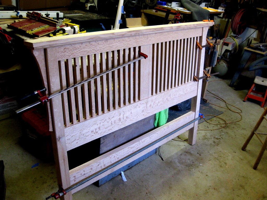

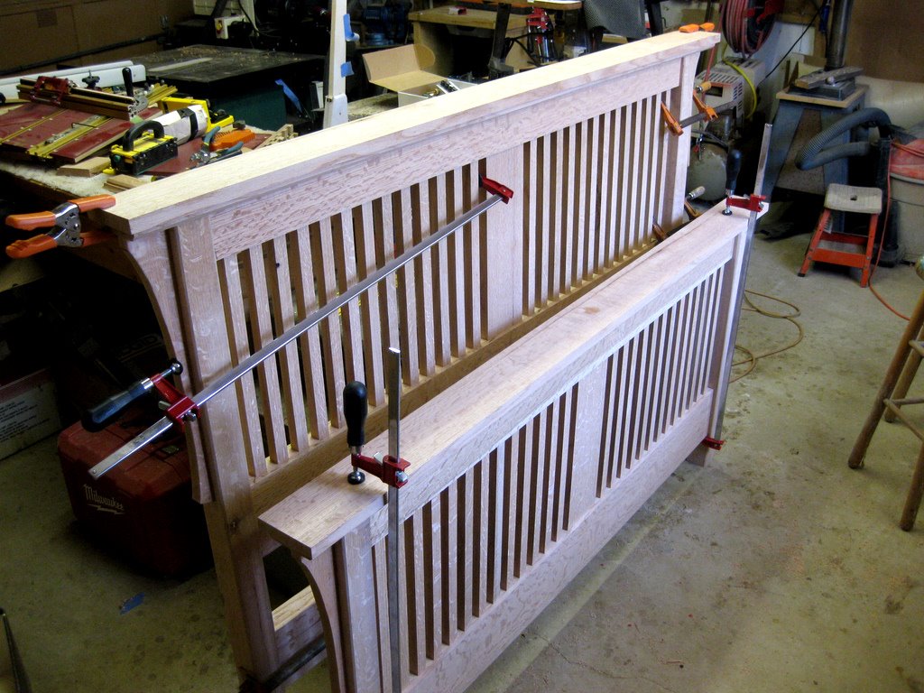

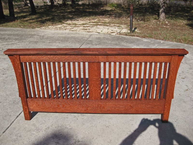

            Dry fit ... starting to look like a bed!
            I've made a little more progress on this mission style bed ... all the pieces parts cut, dry fit and ready for final sanding, finish work and glue up ...

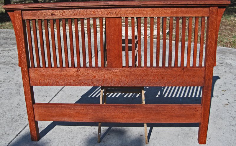

                              Almost done
                              The following pics show the Head and Foot boards after applying the aniline dye coats and before the Seal-A-Cell coat ... after that it's wipe on gel as a glaze to push the brown tone a bit and then satin poly.
                              So far the wife is pleased!
