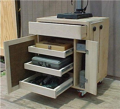

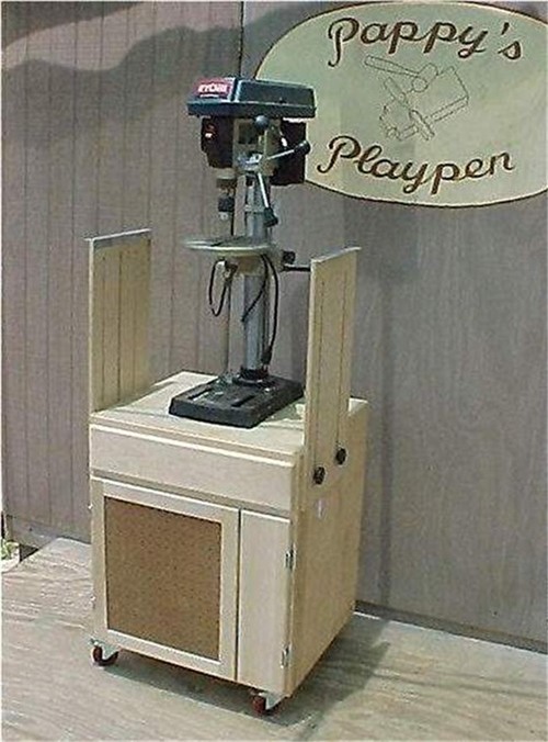

      I have the Ryobi DP120 on a stand. I would have to measure to tell you the exact height, but the hub for the handles is just below shoulder height.

        Pappy - what are the two sliding? pieces on the sides of your cabinet used for? And by the way - it looks very nice.

          The two sliding pieces are supports for long pieces.
          They can be raised so the upper edge matches the height of the DP table.

            Thanks for posting a picture of your drill press stand. That's what I have in mind. I would love to know the height, width and depth of your stand.
              I wil measure it in the morning and post them.
              The sliding panels are what Loring said. In addition to the slots for the knobs, there is a groove in the back of each panel that slides over a piece of MHMW to aid in alignment. I have wood 'caps' to go on the aluminum angle at the top, just never have installed them.
                Mine is similar to Pappys, but not quite as tall. It was made out of a sheet of 3/4" MDF core melamine from Lowes.
                The base is 18x24x24, with casters the top of the base is 28-1/2". The quill ended up at 50" and the center of the handles is at 56". I have some height limitations in my shop, so it couldn't get too much taller. I intended to do some side supports like Pappy's, but I opted to make a larger table.
