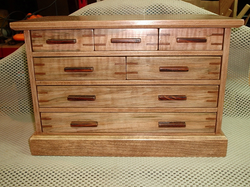

    I'm finishing up a jewelry chest, made of cherry and maple with bubinga (or is it cocobolo?) drawer pulls. The end product is very much less than I had imagined, but here it is.

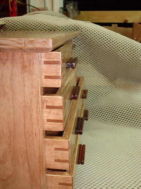

    Here's the purpose of this post. I struggled with how to do the pullls. The top and base are beveled so I didn't want to do curved pulls. I finally settled on these, as seen from the side.

    They're fit into 1/8" mortises, as you'd expect. I ran a v-groove bit accross both top and bottom to give the fingers a little purchase. Resetting the fence, I used the same v-groove bit to bevel the fronts ever so slightly. They're kind of a pain to sand and finish, but I like 'em and hope they get the creative juices flowing for someone else.

    That came out really nice JR. Was the design your own or from plan? I love how the woods compliment each other. What finish was used?
            I found a plan I liked in a Wood Mag book and stuck fairly closely to it.
            The cherry and cocobolo/bubinga (I'm really going to have to find the receipt!) were chosen because they work together so well. I also have a wide plank of figured maple that I used for the drawer fronts. I took care to keep the pieces in alignment from the original board.
            I used Minawax cherry stain. There are quite a few coats on the lighter maple bits, fewer coats on the darker maple, and one coat on the cherry. No stain on the pulls. I used Minwax wipe-on water-based poly on top. I now officially hate that stuff. It dries quickly, but I find it difficult to apply evenly. It's my main beef with the final product here. I made a legendary number of mental errors on this project, most of which were recovered nicely enough. The top-coat just bites.
