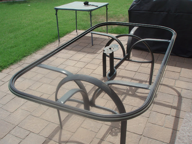

    hello everyone! i am back from "suspended animation" for the time being the job search and bike has kept me really busy.....
    i have a patio table that the glass broke in on its own. i went to get a quote to get glass and they want $350 for tempered glass!!! i cant afford that right now, but need a functioning table. so i have been trying to think of alternatives for topping it.
    got any ideas that would not be very expensive. LOML loves the chairs, they are green aluminum, so we just need the table fixed. any suggestions and ideas is what i am looking for at the momment.
    thanks in advance!
    here is what the frame looks like:
    omar
