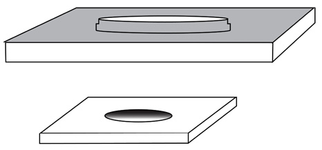

    I need someone to tell me how to do the following:
    I want to make a circular mortise on the top of the lid of my next jewelry box. The hole will be approx 1 1/2" in diameter and go only 2/3 of the way thru the top.
    What I'm stuck with is how to get the bottom of the mortise to "flare" out so you can get a finger pull type pf purchase.
    The following rather crude illustration hopefully shows what I'm trying to achieve.
    The hole will be bored out using a forstner bit, but how do I get the "flare" or undercut. I guess there must be a router bit that does this, as I seen it done on drawer finger pulls.

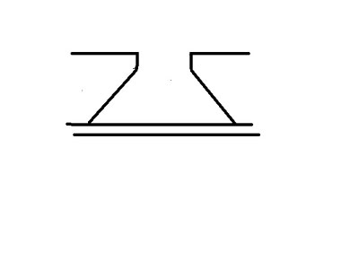

                        This method:
                        I would first machine the hole with the forstner to the depth you want. Then use a dovetail bit with a collar to guide on the hole size. Set the depth of the dovetail to the bottom of the mortise. You want a short step of flat to keep the edge in tact.
                        I did a rough sketch below to show how it would look. Leaving a short flat vertical edge before creating the angle, will provide substantial thickness where fingers grab to minimize tear out or damage to a thin tapered edge, versus a straight edge. The drawing is not to scale.
