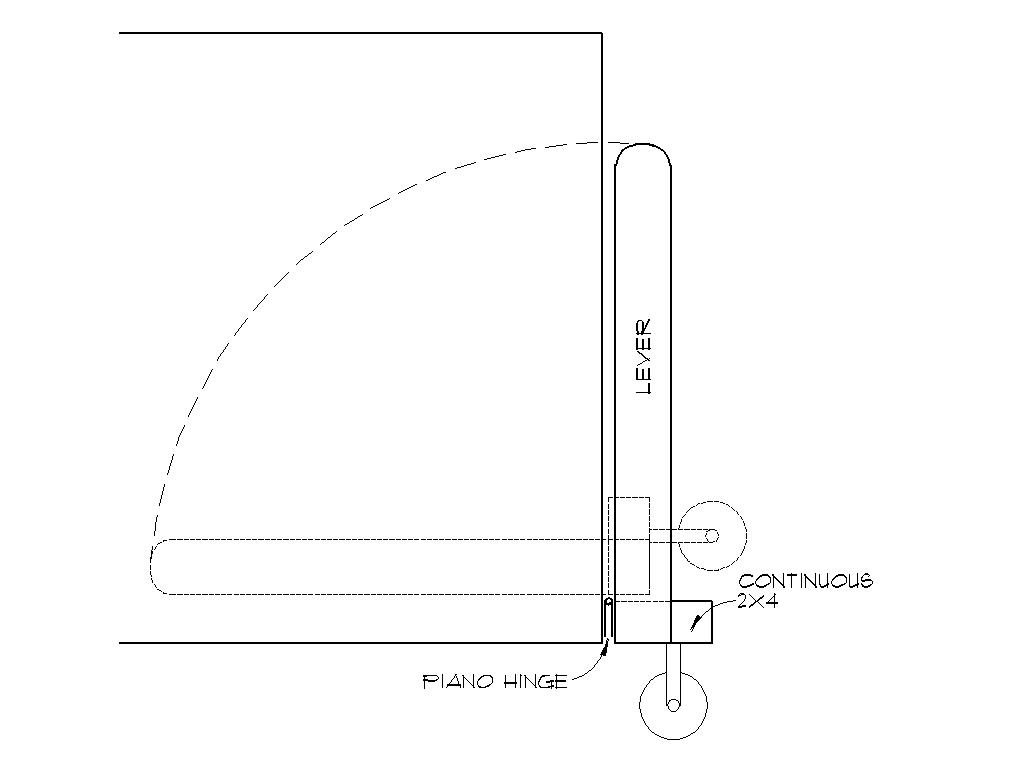

              There are many ways to execute it. Here's one idea; below is a view from the back. The 2x4 (or whatever material) would be the same length as the end of your base. The lever would attach to the end and need to clear the back to rotate. Bolt latches could keep the lever in place when down and up.
                Gosh that is very different to what I thought you meant - A pictures worth a thousand words. I will have to give this some more thought ...
