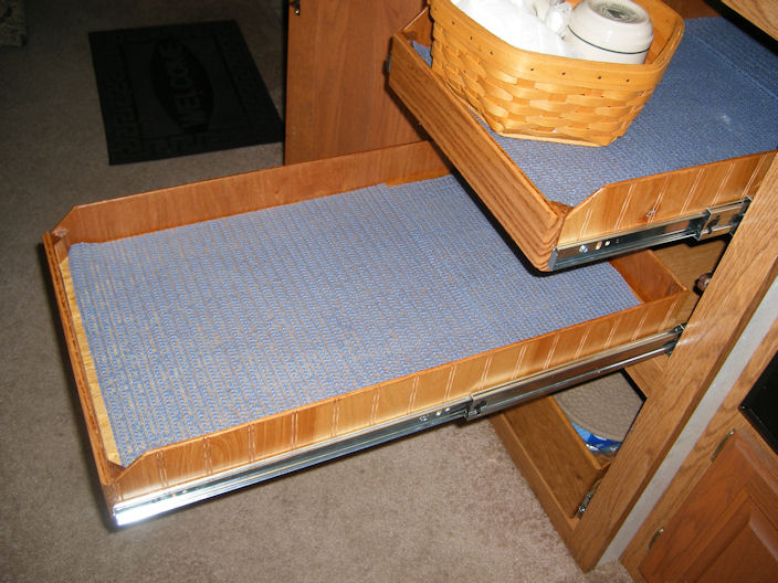

            The bottom drawer in this RV pantry is special. I don't have a clear picture on file and the RV is in storage so I can't go out and take a picture. The drawer slides are mounted on a frame that has 4 dowel pins sticking up. then the drawer is on a matching frame that sits on the dowels. The front of the pantry is about 3 inches deep plus the bottom frame is up a couple of inches. We pull the drawer out and lift up and have a 14" x 24" by 5 inch deep secret location. The only apparent difference in the drawers is the front lip is wider than the rest. We did this after the RV was broken into and they took the wife's purse.

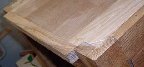

                        I'm working on something now but I don't know if it would qualify for 'secret'.
                        The end table I made has a short pull-out shelf right below the top. This will have thin cork glued into the recess and will be for holding cups and glasses, instead of coasters.
                        I am trying to devise a hidden mechanism to push it out about 1/2", then a recess in the underside can be used to pull it out the rest of the way.
                        'When closed, it will not be apparent that it is a shelf as it will not have a handle to pull.
                        I think I got the mechanism worked out, some of it still in my head..so-to-speek.

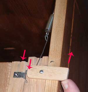

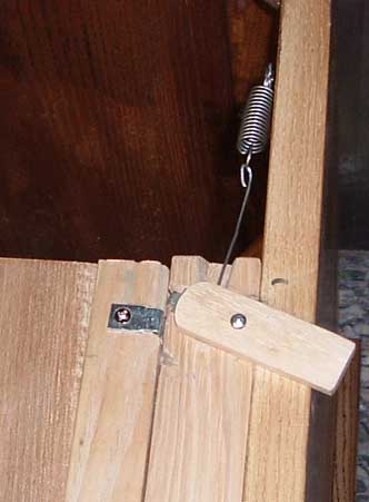

                            Well, you wanted pictures...here ya go.
                            Pictures did not load in order...darn!
                            4 of the pics show the lever pushing the tray forward. It moves it about 3/4". I spring loaded it so it would be in the correct position when the tray is slid back in.
                            The underside of the front lip is recessed so it is easier to pull it the rest of the way out. It slides out about 6".
                            To make it even more hidden, I plan to recess the underside of the top where the lever is located.
