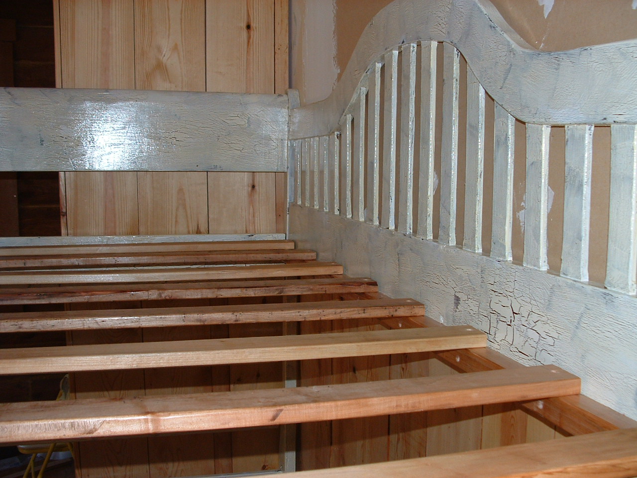

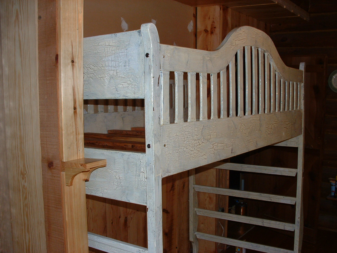

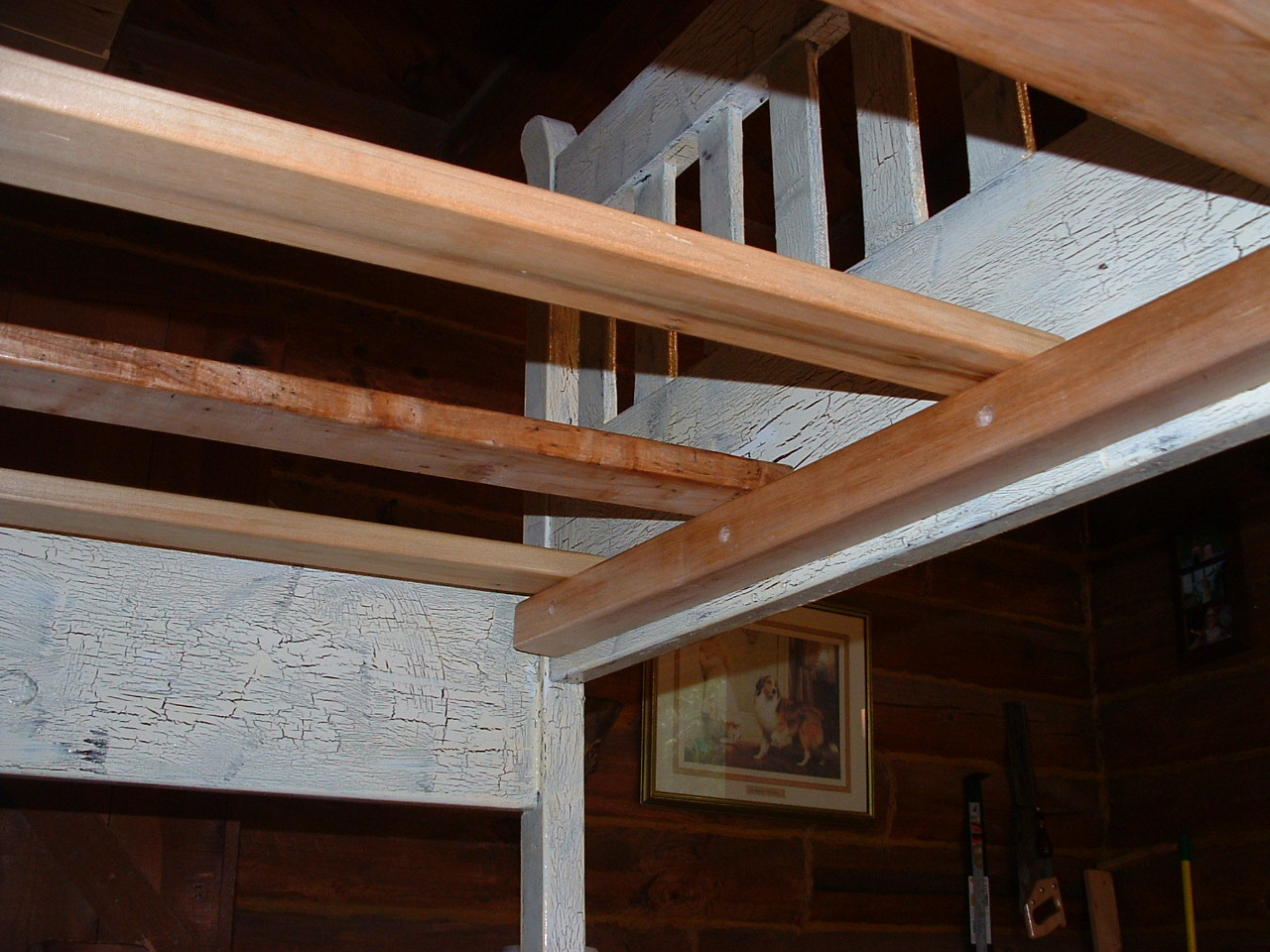

                        I built my kid's bunk out of poplar. I went overkill on the dimensions, though. 2x10 rails, etc. Plan all along was to paint (crackle), so it was my #1 choice.
                        I bought my lumber from an Amish lumber mill, spent about 20 cents a board foot, as they wanted it out of their way. They are in the hardwood flooring business, and needed the space for oak lumber. I took all they had, and am still using it.
                        I have a planer and jointer, so I had no issue with it being rough. If you don't have the machinery, you might be able to rent some time at a school, military installation (if you have access to it), or have your local lumber supplier plane it for you. I think I paid 30 cents a foot to have some really wide boards planed at my local family owned center. I doubt box stores will offer that service.
