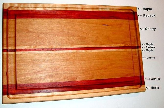

    I am making cutting boards / trivets for Holiday gifts. They will be various combinations of padauk, walnut, cherry, and maple. (See photo of one example.) I prefer to not cut grooves, but the LOML says I should, at least in the larger cutting boards.
    The problem I am having is burning of some of the wood, especially around the corners where I slow the rate of cut. I need help on how to avoid the burning on mixed wood projects. Is there some combination of depth of cut, rate of cut and router speed that would minimize burning without causing tearing?
    Note: I also need to practice following the template and getting straight-edged grooves.
    Thanks for your help. Regards, Steve

                I had used three passes to cut the grooves shown in the picture, which is around 5/16 inches deep. I guess I will have to plan on using more passes, the last two or so being in the range of 1/64 - 1/32 inch. JR's suggestion give a good clue as what a "light pass" really means.
