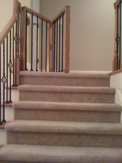

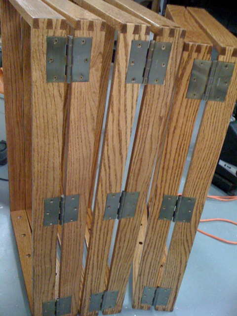

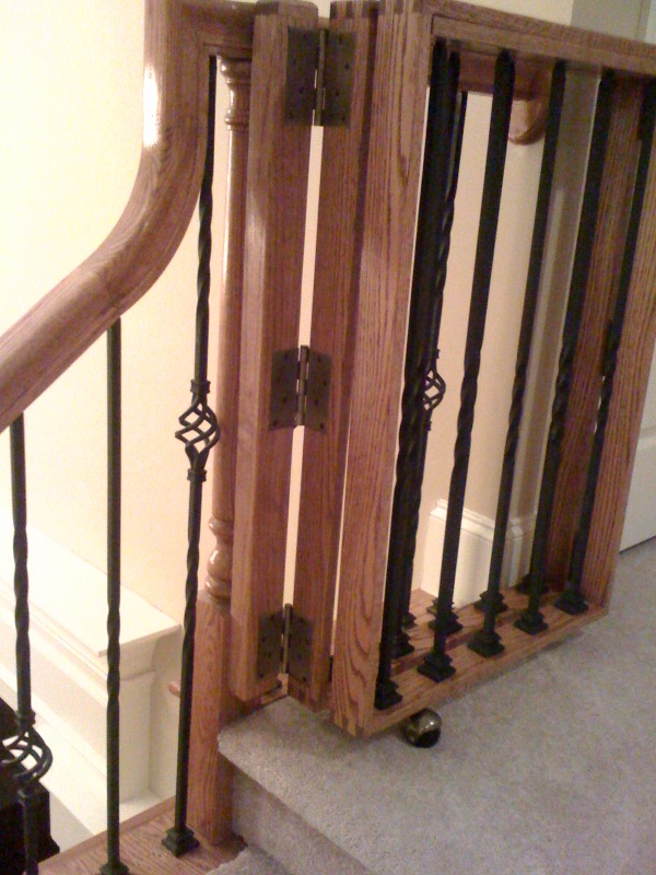

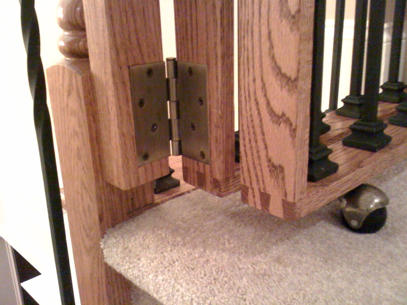

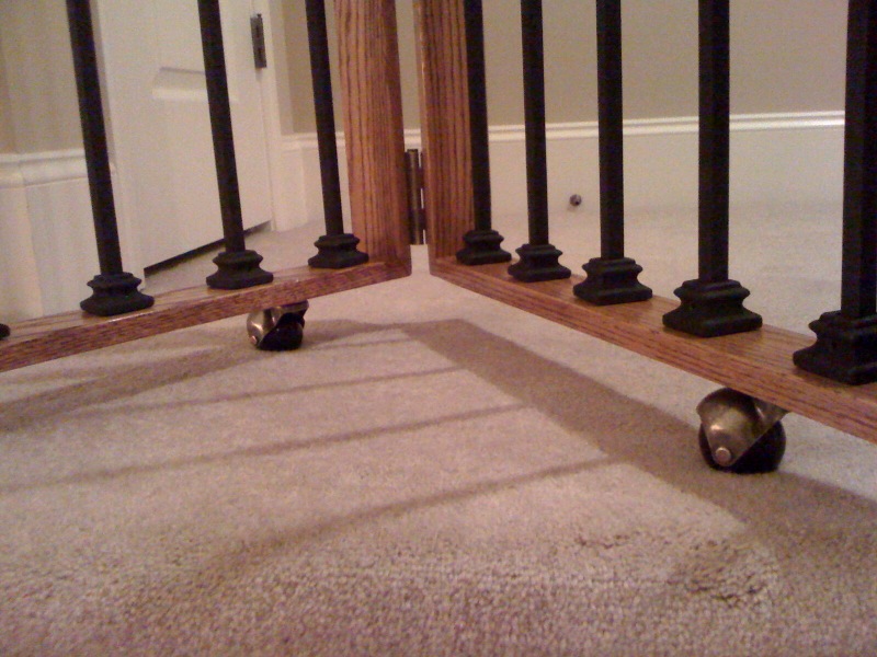

    I made three beautiful baby gates out of oak and iron. Two of the gates will mount to studs in walls, but one of the gates will mount at the top of a staircase. This is my challenge.
    Due to the weight of the gates, I have wheels at the bottom so it rests on the floor. This removes all of the weight requirements from the round post.
    The bottom of the post is a nice solid block, but the top is a tapered round surface which creates difficulty in attaching.
    I have fabricated a nice solid block of oak to which the gate attaches with three 4" hinges. They're beautifully mortised, by the way
    So all I need to do is attach the block to the post. The base seems pretty easy. I figured I use some large lag screws with washers. Or maybe even a through bolt.
    How can I attach the top of the mounting block to the tapered round post? Can I drill a hole directly through the post? If I do that, the bolt or screw will be visible as the tapered post doesn't sit flush against the block.
    Maybe I should fabricate some sort of split curved jaw-like wing-nutted clamp device that squeezes the post creating a flat surface which to attach the gate.
    For now, here are some pics of the gates.....

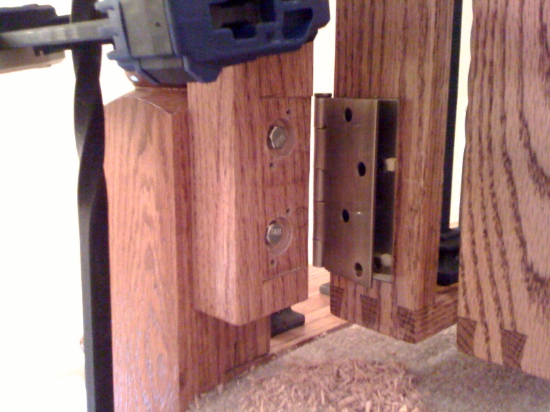

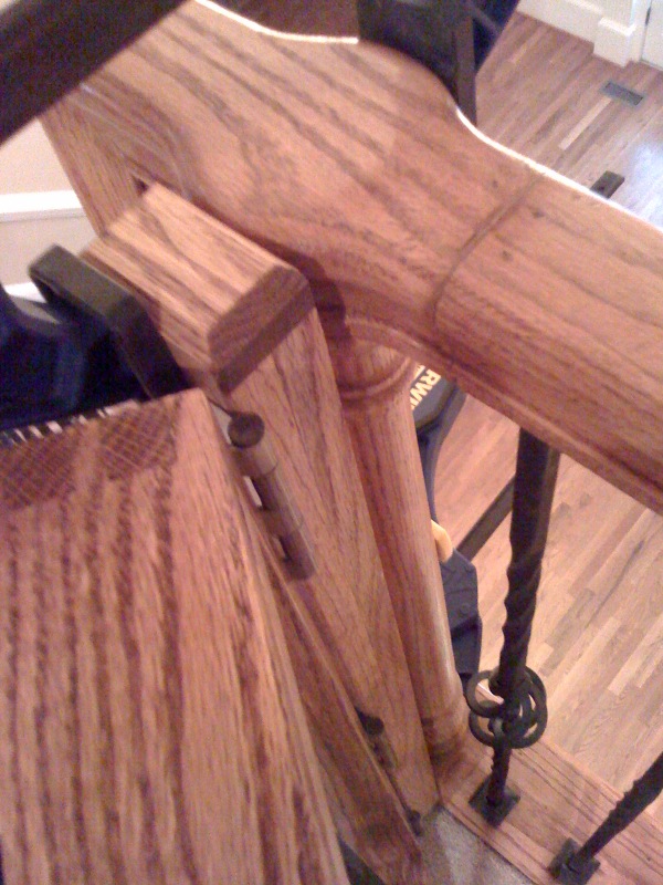

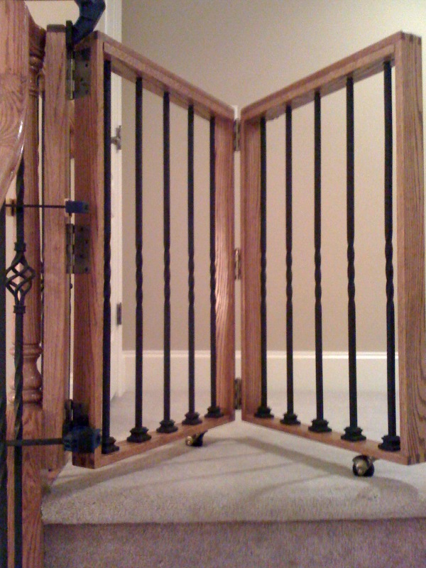

                      Mounting Bracket
                      So I went the simpler route and made a 1.5" thick mounting bracket to which the gate attaches. Then I just need to mount the bracket to the post.
                      Check out these picks. Right now it's secured with clamps, but a couple of bolts will do the job.
                      Now that the gate is on wheels and the bracket is attached to the gate, all of the weight is on the wheels. So I just need something to keep it anchored on the post side.
                      The clamps, right now, are not super-tight which shows me how I might have been over-thinking this.
                      I plan on driving a bolt through the square base of the post, and another 3/4 up the tapered post.
                      Thoughts?
                      Check out the cap I added to the top of the bracket. It's all about the details!

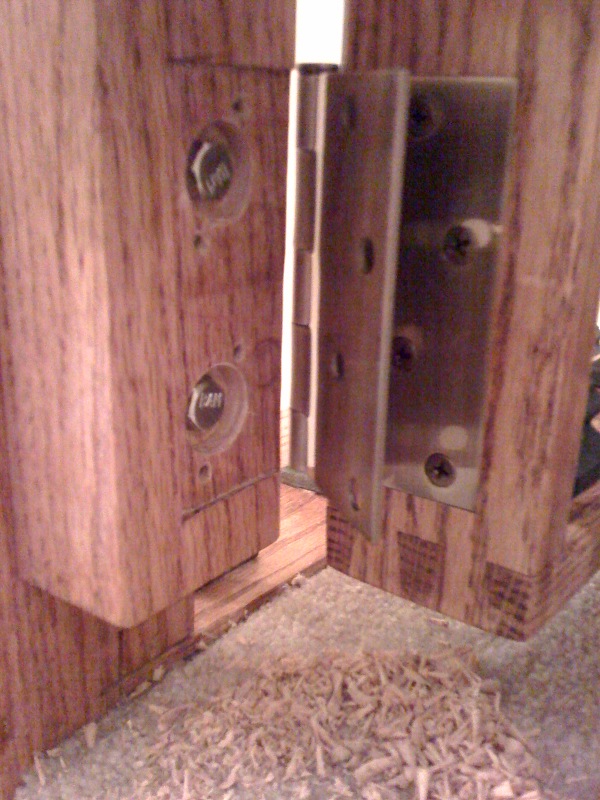

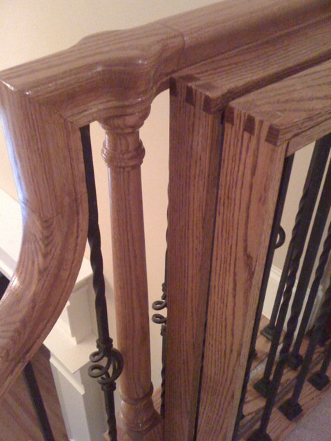

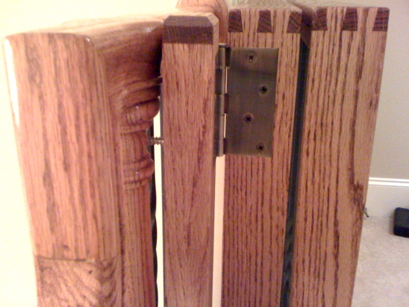

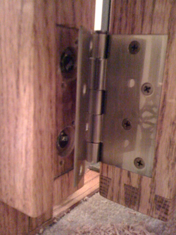

                              Gate Finally Mounted
                              Thanks to all of you fellow BT3-ers. Great ideas and quick response. Yesterday I finally mounted it after having an epiphany. I decided to use large lag screws driven directly through the mounting bracket. I needed to counter sink the bolts so the gate hinges could close fully.
                              Instead of leaving the bolts visible, I unscrewed the uppermost and lowermost hinges one at a time and used a 1" forstner bit to make a large enough hole to hide the bolt head, while still allowing the ratchet head to fit in so I could tighten it all the way. I used two lags at the bottom and one lag at the top.
                              The gate is rock solid now and after flipping the hinges back over the bolts, nothing is visible. You can barely see the threads of the lag screw at the top hinge, but of course I'm going to hide them with a small piece of oak that splits in two and surrounds the exposed metal.
                              The weight is on the wheels, so these three lags are more than enough to anchor the fixed side of the gate. I'm very happy with this.
                              Thanks again!
                              Here are some photos...
