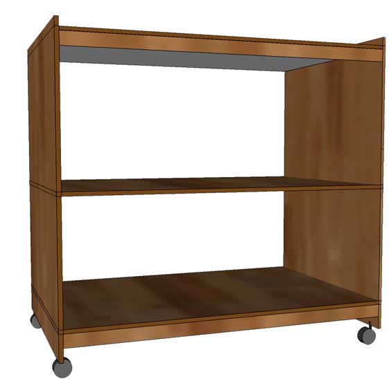

    Sketchup..1st try
    Boy do I have a lot to learn.
    I cannot figure out how to get rid of the lines on the end panels.
    If I erase them, the shelf gets erased.
    • 9555
    Your panels intersect instead of meet. If you can select the end of the lower panel, use the push pull tool to bring it to the inside face of the meeting panel.

      or you can go into views, and turn off display edges... that will get rid of the lines

        if the shelf get erased when you erase one of the lines, then it is because it is one of the shelf edges you see there. One way to do this is to design it the way you would build it, meaning have the shelfs fit into a dado at that point, and leave the lenght of the shelf the corrct length. If you move the mouse over the shelf end you should see that face getting highlighted and you should be able to push it in 1/4" - that should at least take care of the lines showin in the sides face.
        oops - just noticed the second pust said just that ... sorry for repeating

          Now I have some specifics to learn. Push/pull tool for one thing.
          I remember other drawing programs where you could 'nudge' a graphic using the cntrl-arrow keys. No such thing here.
          Jesper, asr you saying I should create the dado slots in the sides and then create the shelves?
          Would it easier to manipulate the shelf if I forst enlarged the image?
          Like I said, I have a lot of work to do to learn this...buit I want to so that is in my favor.
          Thanks again all.

            I would create the shelf the size you want it, then convert it into either a group or a component.
            Then create the side, add the dado where you want it, push it in the 1/2" or however deep you want it. Then convert that into either a group or a component.
            Now you have say a left side and a shelf - 2 components (or groups), now you can grap the top-left-front corner of your self, mover it to the top-inner-front corner of your dado in the side, and the shelf will 'snap' in place.
            It might sound complicated, but it is really easy. Definitely look into groups and components and use it extensively. I'm by far NO expert in SketchUp, but when I use it I turn pretty much every little 'thing' into either a group or compoenent, depends on how you want to reuse it. That way you can easily move 'parts' around or hide or edit 'parts'
