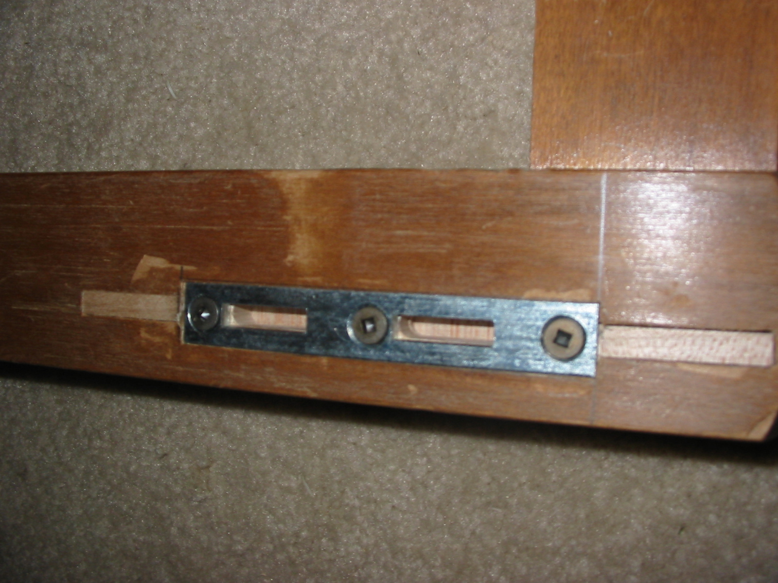

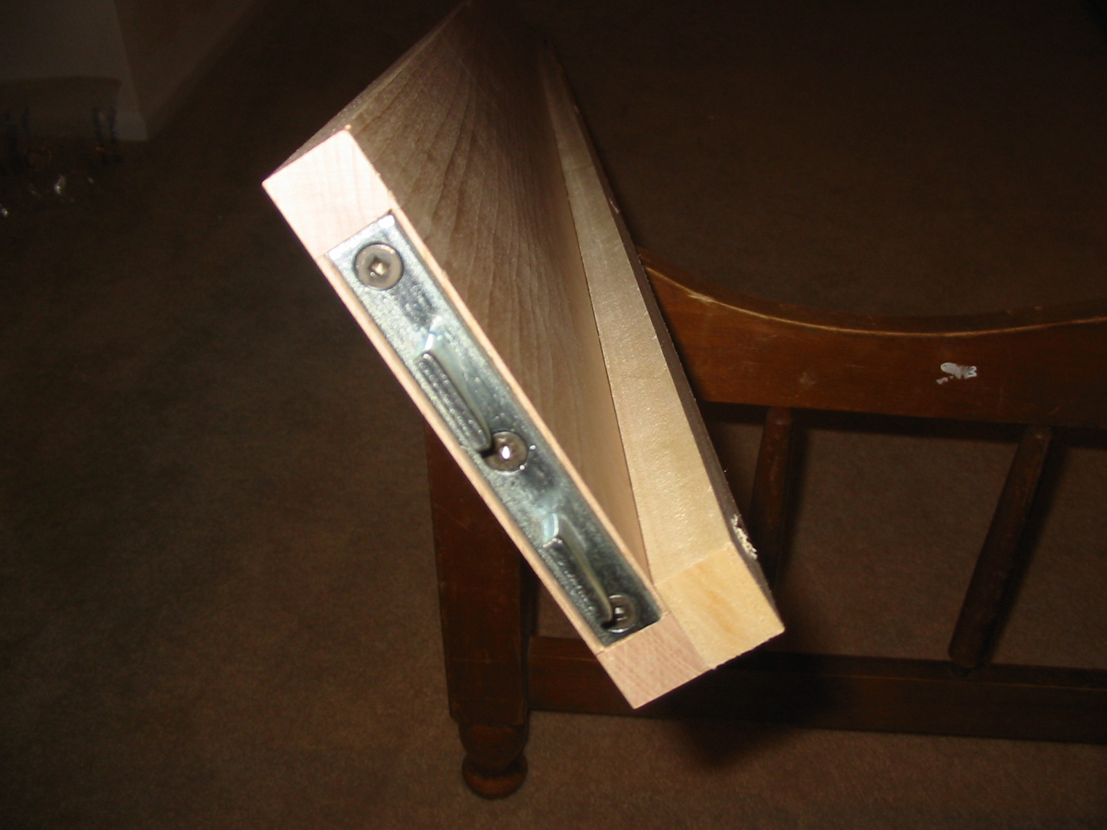

On my daughters bunk beds we used the Heavy Duty Wrought Steel Bed Rail Fasteners from Rockler. They hold very tight.. Takes a hammer to knock them off.
http://www.rockler.com/product.cfm?page=10
Pics of the installed plates here
headboard
http://www.pontiacs.org/pics/project...d/IMG_0138.JPG
rail
http://www.pontiacs.org/pics/project...d/IMG_0136.JPG
