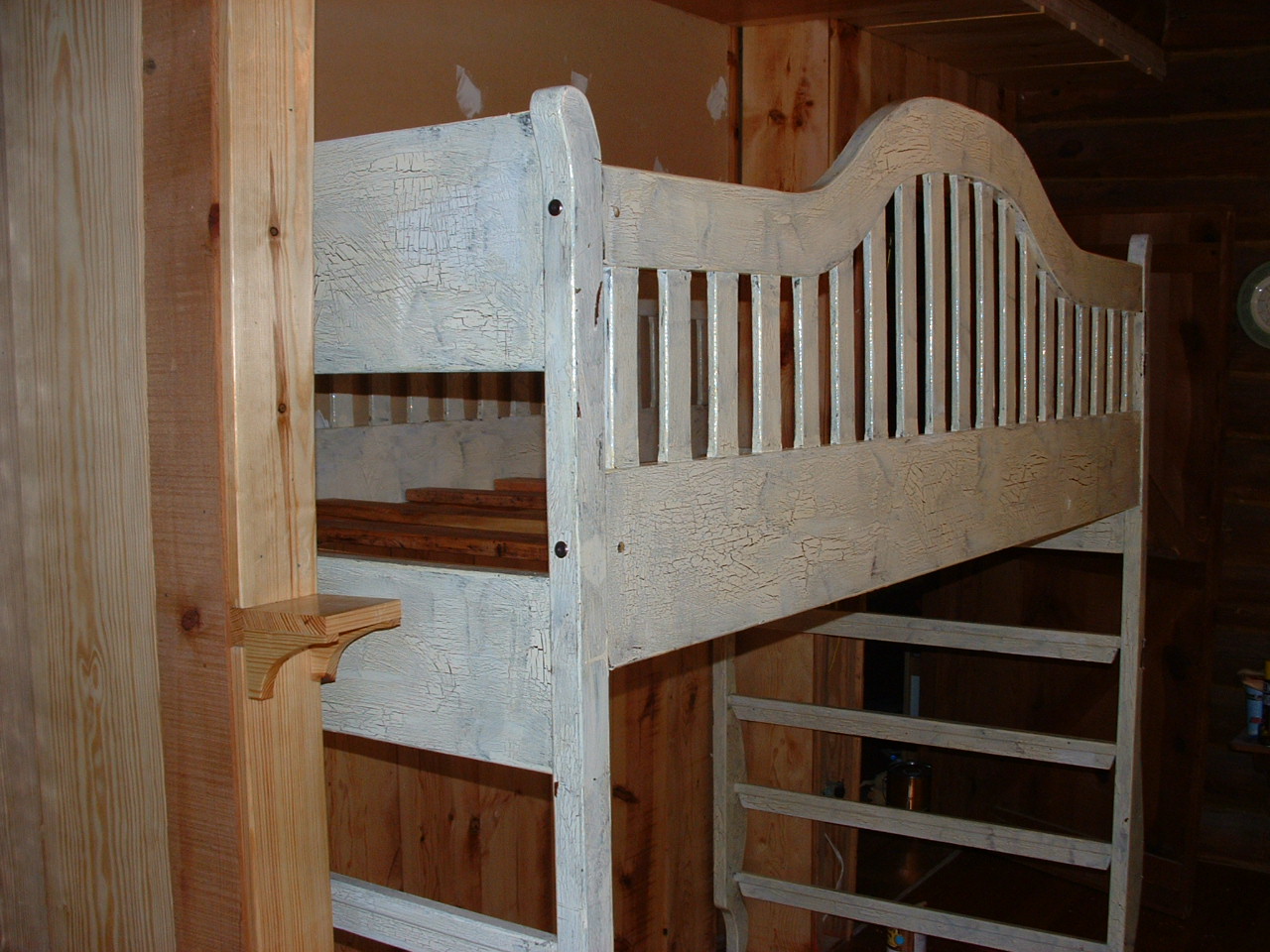

            This is the closest photo I could find. You can see on this one the rails appear to be attached with lag screws as already suggested.
            My saw is a CMS, not a SCMS. Thanks for the suggestions.
