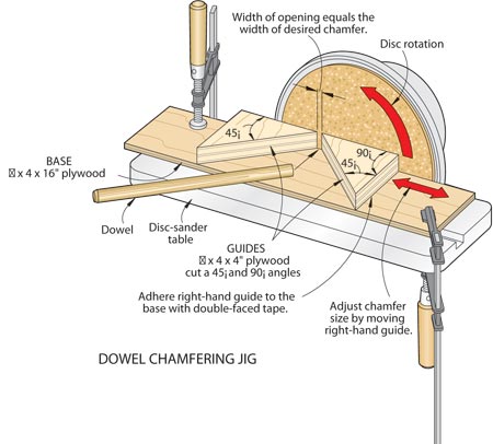

      I guess you saw this from WOOD magazine?
      Downunder ... 1" = 25.4mm
