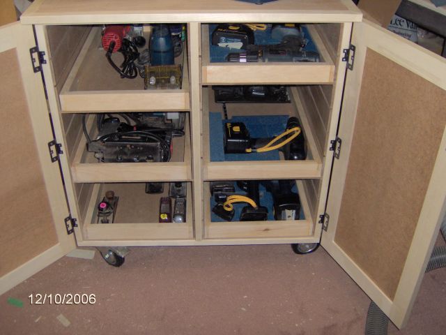

          Not sure what you are exactly looking for but I made this tool cart to house bunch of tools as well as place for bench tools:
Name:	tool cart 1.jpg
Name:	tool cart 2.jpg
          I have not decided what goes on top permanently but this should give you an idea. The plans are from ShopSmith that I had to adjust for the dimensions. Let me know if you are interested in the plans.
