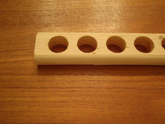

    so how much can material can you remove from a 1x2 to reduce weight and keep the same stiffness and strength?
    Something done in metal trusses all the time: skeletonizing
    Possible Main beam for a trebuchet...
    Skeletonized by drilling 7/8" holes every 1.25" (32%) and the edges 3/8" rounded over, (10.6%) - 42.6% weight removed; still seems quite strong...
    Where else can you take stuff off? I think two 1/4" holes off center between the big circles will save another 5% to make nearly 50% weight savings.

      Unlike metal (as far as I know), wood tends to fail in a particular direction- with the grain. Seeing as you plan on using it for a trebuchet, I'd be very careful about removing more seeing as its going to have to support the weight (and motion) of the counter weight, I could see it splitting the 1x2 right down the middle.
      Also, since the moment of inertia is directly proportional to the mass, how much of a performance increase is an additional set of holes going to add to say, running it through the planer, or making it shorter/narrower? I'd be willing to be planing it down to 5/8" would keep it stronger and would cut the mass to about 52.2%

          I fear that the wood with holes is not as strong as you think. I MIGHT be okay with those holes gone and rounded, but that splitting is a common problem with overloaded wood.
          Try clamping a piece at each end, then hang heavier and heavier weight on it. One way would be with a hanging scale and something like a duffle bag loaded with tin cans.
          Do the same test with an untrimmed piece of 1x2 and a piece trimmed as you are trying, then let us know what you learned.
          But be careful to get nice straight-grained pieces that are comparable. With a lot of the 1x2s I get at my building supply superstore, there are plenty of flaws that weaken it.

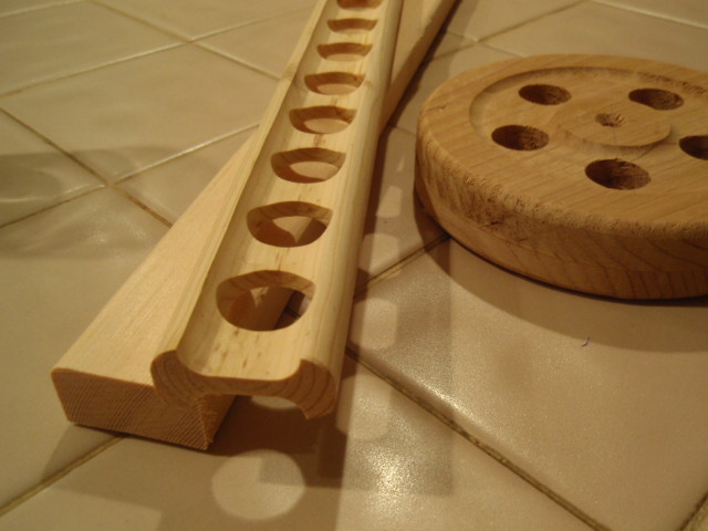

                    what about this? Seems pretty strong and stiff and only 34% of the weight of the solid 1x2.
                    According to the Treb modelling program a 50% reduction in beam weight can create a theoretical 20+ percent range improvement for my sized projectile and CW.
                    In weapons, range is everything. When fighting a battle do you want to be the side with the 100 yard bow and arrows or the 120 yard range bow and arrows?
                    RNelson: the Treb gains distance by converting potential energy to kenetic energy. and then getting the KE from the weights to the projectile. The bigger the beam mass the more KE goes into moving it rather thant he projectile. A zero mass beam is ideal but not doable, the max performance is to make the beam only as strong as it has to be and no more. A stiff beam transfers more KE to the projectile than a floppy one. So light and stiff are the keywords.

                      can you wrap that in a single layer of fiberglass?
                      or what about laminating several 1/8" strips of ply together, and then removing material
                      ply / fiber / ply / fiber / ply / fiber / ply

                        I think it should be pretty strong. I guess the weak point is the thinner wood between the holes, but I suspect that it will be plenty strong for its intended application.

                              It's a two-piece beam, the part supporting the coutnerweights is stronger and doubled up. Some designs sport tapered beams. To do that you need to be able to calculate the width at the fulcrum and the width at the tip for the strength you need. Overall, my perforated beam will fairly light but stiff, I hope I don't need to taper it.
