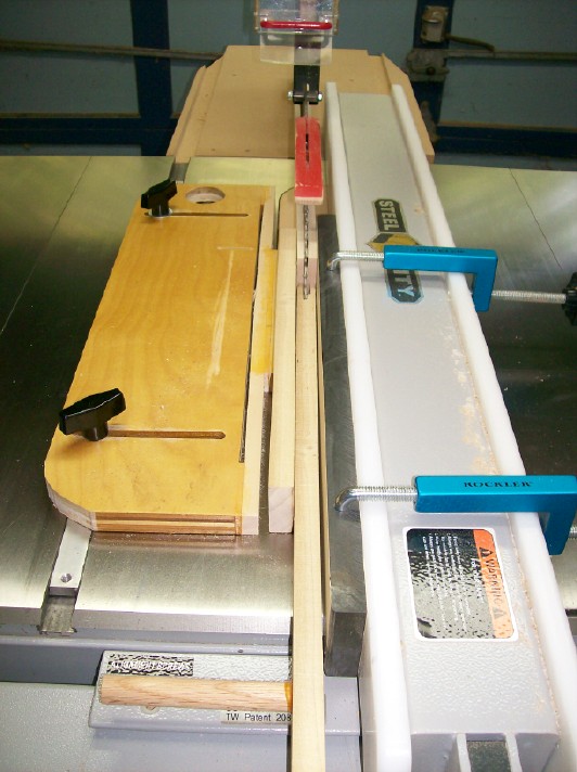

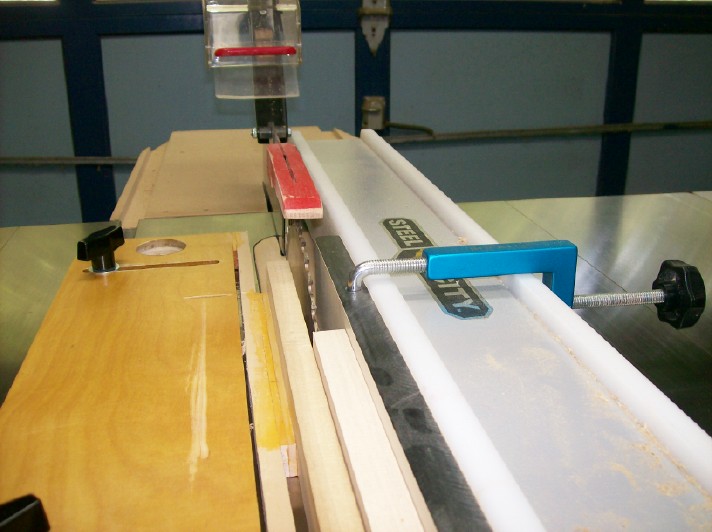

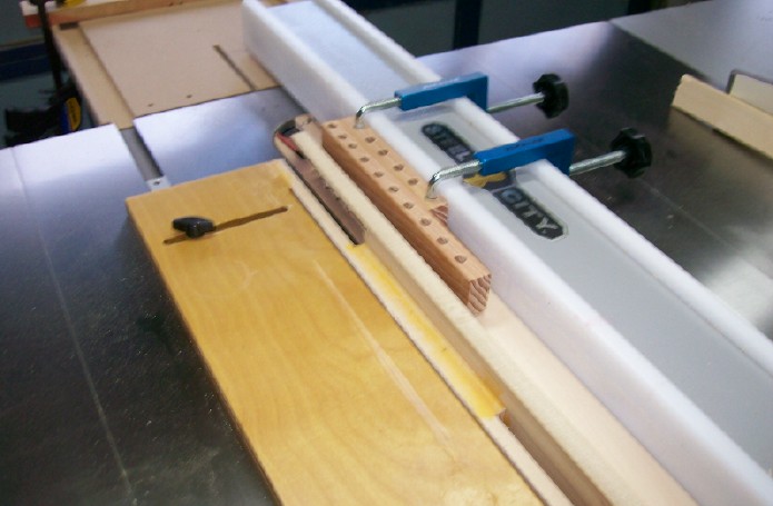

                      So... I just went down to the shop do exactly what all the fuss is about here.....
                      3 minutes to grab a piece of maple out of the scrap bin.. put batteries in the digital camera.. set up the support opposite side of fence.. grab a sacarificial push-stick and make the cut.. Hands never closer than 8" to the blade and body standing out of the Lane.
                      I gotta run as I'm putting final touches on a desk-hutch.. Ya'll have a good day.
                      Opps.. disregard picture on the bottom. I will add the correct one....
                        Opps.. missed one...
