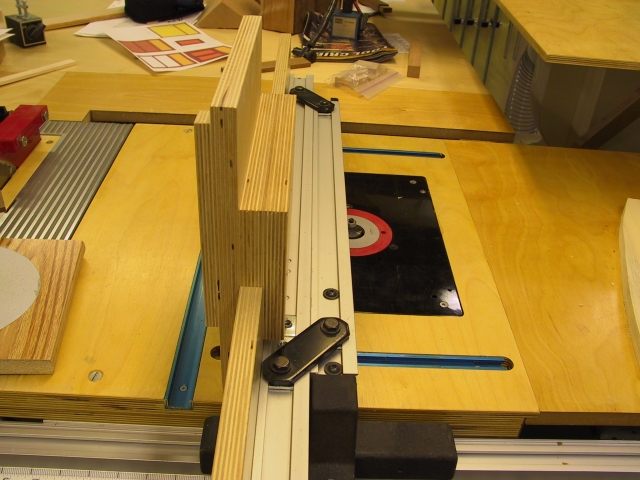

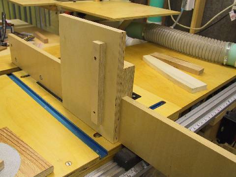

    I vote for #1. I made a long-n-tall fence some time back, and since then have built a number of jigs that ride the fence.
    These pics show the fence and the tenon jig I use.
Name:	Tenon Jig - Rear View.jpg
    You could either use the tall fence alone, or make another piece that rides the fence and clamps your workpiece for added security. Either could be taller than what I've shown if needed.
    If you're concerned about "tippiness", you can always add a counterbalance that wraps over the fence. Some folks here have made an "h" shaped (in cross-section) fence add-on. But, I haven't run into any trouble yet.

      I like what you have done here. I was thinking along the lines of an "h" style, that way it could fit to the fence when on either side of the blade as the fixings on each side are different.
