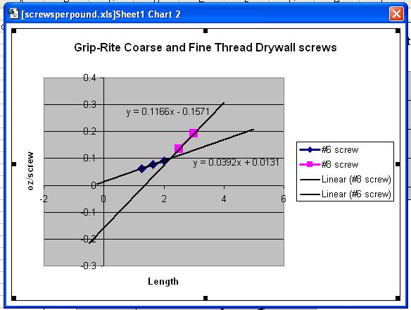

            #6x1.25 258/pound
            #6x1.625 200/pound
            #6x2 175/pound
            #8x2.5 119/pound
            #8x3 83/pound
            from amazon listings of 25-pound bucket drywall screws
              • 22053
              I would not trust the figures I gave you.
              If you convert it to oz/screw and plot it and run a regression you would expect one line for #6 and one line with a steeper slope (in oz per inch) for #8 screws, since the #8 would be nearly twice as heavy per inch being probably 1.5 times as thick in the body of the shank.
              the wequation of the weight for this kind of screw (constant shank)
              would be expected to be:
              Wt (screw) = weight of head + weight per inch x # inches.
              The Y-intercept should be basically the weight of the head of the screw.
              Assuming the #6 screw dat is correct This tells me the #6 screw head alone is .013 oz and the shank is .04 oz per inch.
              But the #8 data shows a largish negative intercept. the slope is 3x larger but the intercept can't be negative.
              So all this data is suspect, maybe the #6 data is correct, at least its in an expected line, the #8 data only has 2 points.
              **** engineers have to analyze everything.
