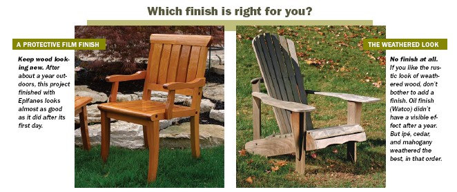

            Fine Woodworking Mag just did a year long clear finish test. Article is here
            if you have an online subscription:
            http://www.taunton.com/finewoodworki....aspx?id=32304
            They chose Epifanes Marine Finish. It kept all the wood samples looking
            relatively new in 5 different climates around the country.
            Paul
                      Paul
                      Thanks for the link Paul - very good review there.
                      I am sufficiently impressed by their report to order the 'winner' (Epiphane) for myself :
