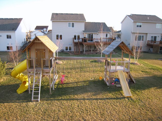

I built my own for not a lot more money that the store bought ones, and a lot less money than the Rainbow systems.
It was one of the funnest projects I have ever done.
Here is a few more pics:
http://picasaweb.google.com/seekins/...eat=directlinkComment
