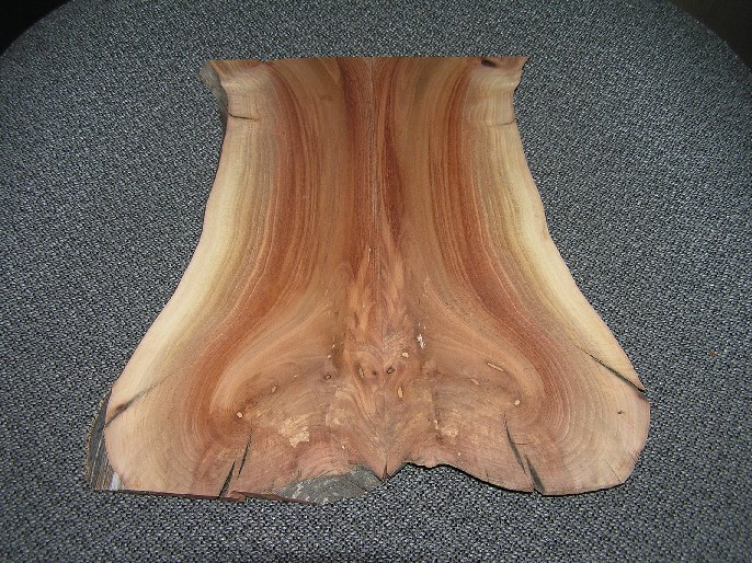

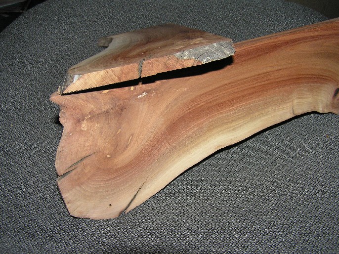

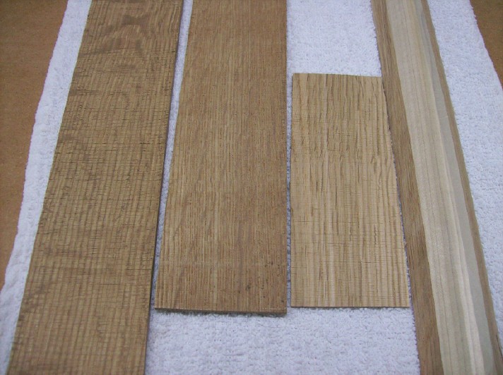

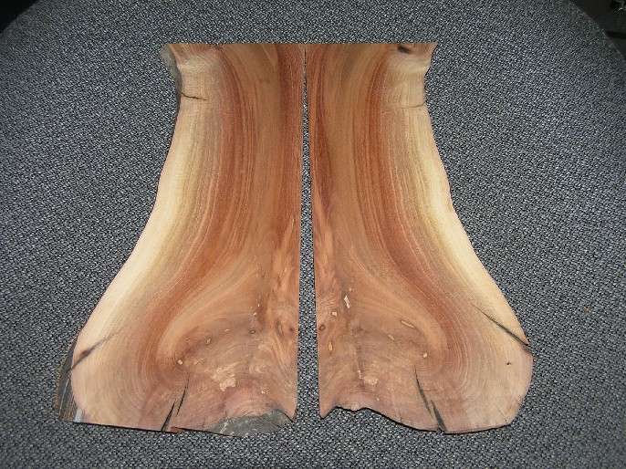

        I'm using a Timberwolf 3/4in low-tension 3tpi hook on my 14" Delta, and getting very good results at about ~.045in kerf. However, BS kerf is seldom smooth, and when I resaw for 1/2in rough thickness, my boards finish at circa 3/8in (.350-.400in) thickness after jointing and planing. YMMV. I'm including some photos of some Manzanita I resawed on Sunday (again, at 1/2in rough thickness, fininshed at just a hair over 3/8in (.380in)
