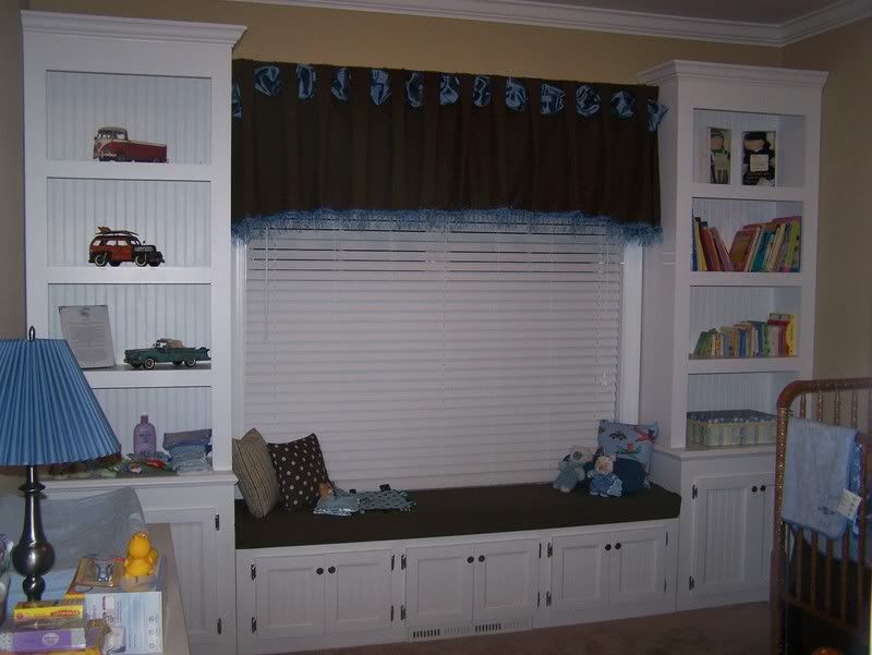

        I know this is an old thread but the previous poster hit on a problem I've come up against.
        I completed some built in bookcases and primed and then painted them with latex. It's been several months and anything I set on them sticks to them (the paint remains in tact and no marks are left). I have another project to do and I want to finish it right. How do I paint furniture with so that the finish feels hard and smooth and doesn't stick to things?
        Also are my bookcases salvageable?
        What is the process for painting and what are the materials I should be using finish wise?
        Thanks.

            The characteristic for items to be sticking is called "blocking". Depending on the sheen of the paint used, both latex and oil base can be subject to blocking. Oil base paints can have a long "cure" time, and should over time become resistant to blocking. The higher sheen of a latex when cured fares better than semi-gloss or flat finishes.
            If you can spray a finish (compressor/gun), a lacquer finish, or a waterbase polyurethane would be your best bet. If you can't spray, lacquer is available as a brushing lacquer. With waterbase finishes, latex can be added to waterbase polyurethane, or clear, can be tinted with a color.
            To save what you have, if time doesn't provide a cure, you can overcoat with an oil base paint, or a waterbase polyurethane, but NOT with a lacquer.

                One of the "benefits" of latex is that it never fully cures - it remains flexible and "sticky", to a degree, forever.
                Oil paints dry to a hard finish, but you are likely to have problems applying oil paint over latex. If you use a sealing coat between the layers, you may get it to work, but you will have problems if you apply oil paint directly over the latex.
                Pure acrylic paint would be another option - it can be applied over the latex and will cure to harder finish. Note that "100% pure acrylic" paint is DIFFERENT than "acrylic latex" paint.
                As a general rule, applying different classes of materials over each other will cause problems - so applying any poly, oil paint, or anything else other than latex paint or a "close relative" such as acrylic over the latex paint will give poor results at best and cause problems like crazing at worst, depending on the particular combination of products.
                If it were me, I would strip it to bare wood, seal and prime with a shellac-based sealer/primer such as Zinser Coverall, then paint with an oil-based paint.

                  Most of the waterbased polyurethanes work about the same. Some seem more durable than others. I've switched from lacquer to WB poly about 20 years ago for most all my finishing. Off the shelf at HD, Parks Pro Finisher would work well, and a catalyst is available. It's recommended for finishing floors, and works as well on furniture.
                  As for a latex, an interior type would likely be available in a higher sheen. Any of the "best" of the popular brands will work well. I wouldn't recommend using a straight latex for furniture items.
                  If you choose to use an oil base paint, lightly scuff sand the finish with 320x, and paint. You could use a sealer like Zinseer Seal Coat as a primer. I've painted over latex with oil base paint with no problems. I wouldn't recommend putting latex over oil base.
