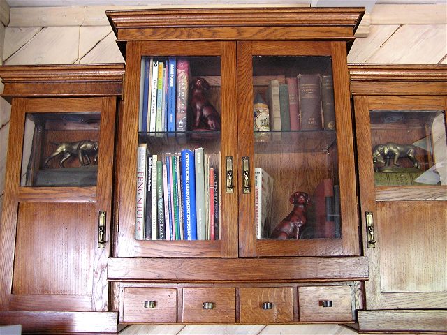

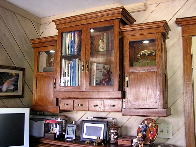

                Ian, Here is a secretary unit we made last March. I stained it to match my roll top desk, that is old. I used the English chestnut and Provincial stain. Also gloss Minwax varnish, sanded down to the desired finish.
                This cabinet is mostly white Rift sawn oak, only the drawers are QS white oak. Notice the molding on top of the center doors, as well as the doors -- how many dark areas of wood is flowing through? Without the BLO applied first, this softer dark wood would have taken on the stain much darker, and in my opinion, would have changed the overall look of the entire piece. We also integrated two thin strips on walnut in the top molding.
                BTW, I purchased the pulls (on the doors) at the link I gave you for Van Dykes, I think they were only about 3.50 each. The knobs on the drawers I got at Home depot and antiqued them to match the pulls.
                Study the close up photo, you'll see how the darker wood is more even toned because of the BLO.
