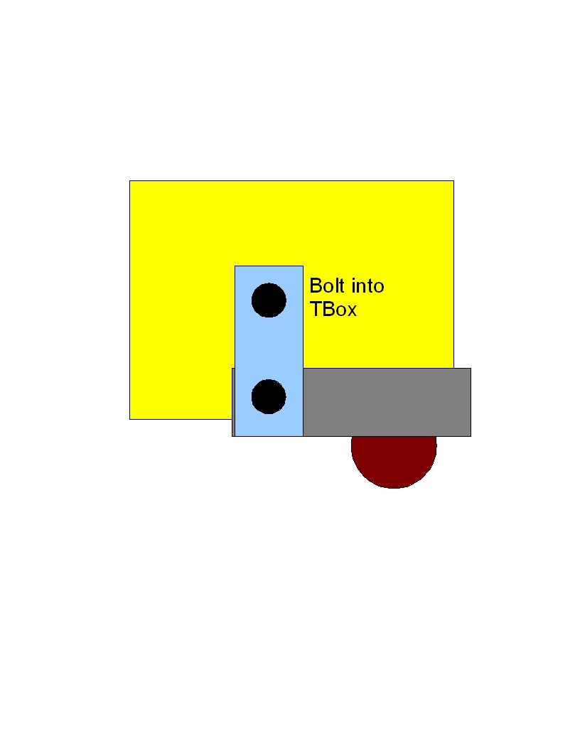

              ...I cant quite picture what you mean by "attaching a strap" can you clarify?
              Something like this -- the blue vertical piece is the strap:
                [ATTACH]12433[/ATTACH]
                Thanks Tom, now I get what you mean.

                    I did meaure the height of the side holes and they appear to be 13/16 above the base plate. If I skin the base with 1/2" that leaves me 5/16 and allowing for a 1/4" lag bolt should mean there will be 3/16" clearance from the skin. My intent was to fix some 3/4 ply inside the corners of the torsion box to screw into.
                    Also if you look at the construction of the corner bracket you will see it has a thick metal plate across the bottom. this is a triangle approx 6x6". I was thinking of drilling holes through this so I could add some larger lag bolts from underneath into the ply inside the box.
                    One last thought was to skin edge of the box with ply (over the MDF) a) for cosmetic reasons and b) it will give the lagbolts something to bite into even before they go through the mdf edge of the torsion box.
                    I cant see anything too wrong with this picture, please tell me if I have missed something really stoooopid as I intend to start construction this WE.
