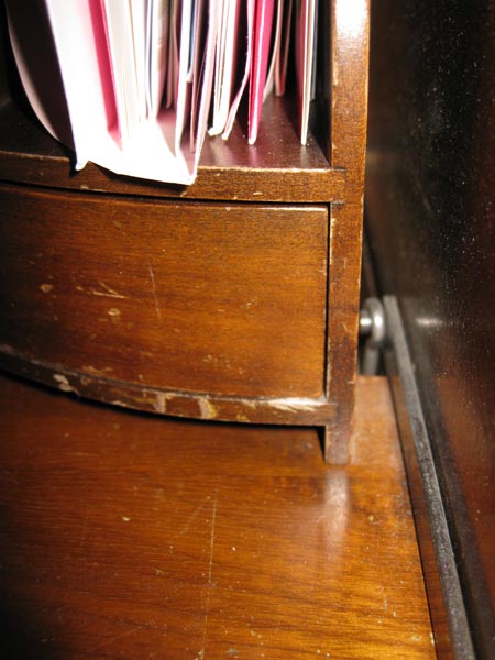

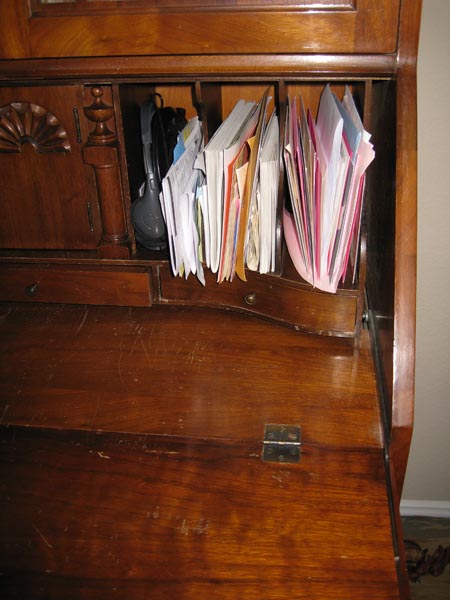

                      Did it have a rope or wire attached to it? I think you should go take plenty of pictures as this sounds like a neat deal!
                      I'm pretty sure it is a metal connector. It's been a while since I've seen it. I'll try to stop by after work tomorrow and get some photos. It is a really striking piece.

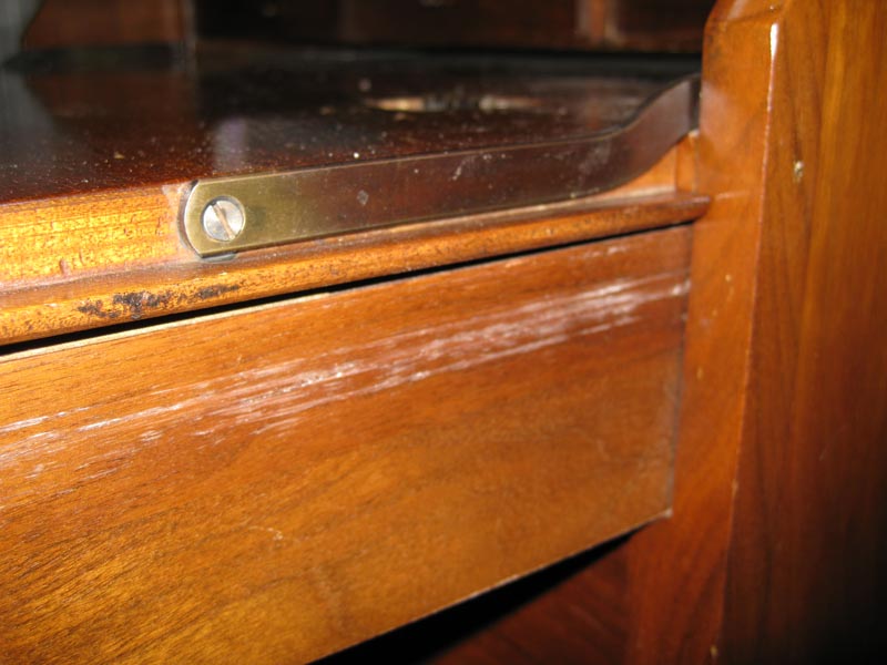

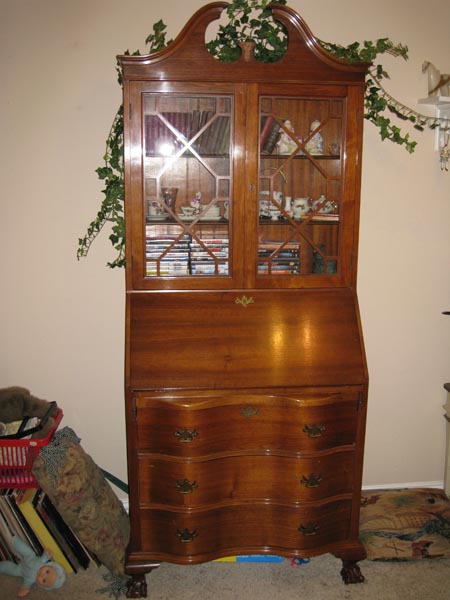

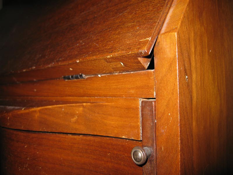

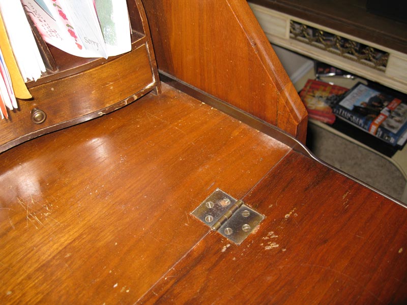

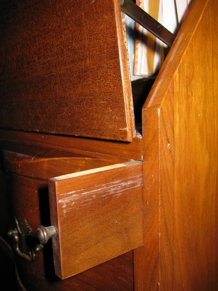

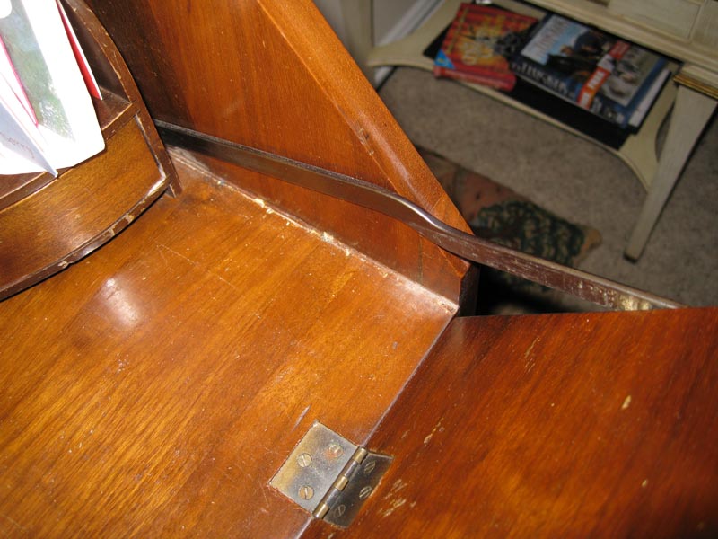

                              I forgot to get the photos earlier, but I finally remembered it when I was over there today and saw the piece.
