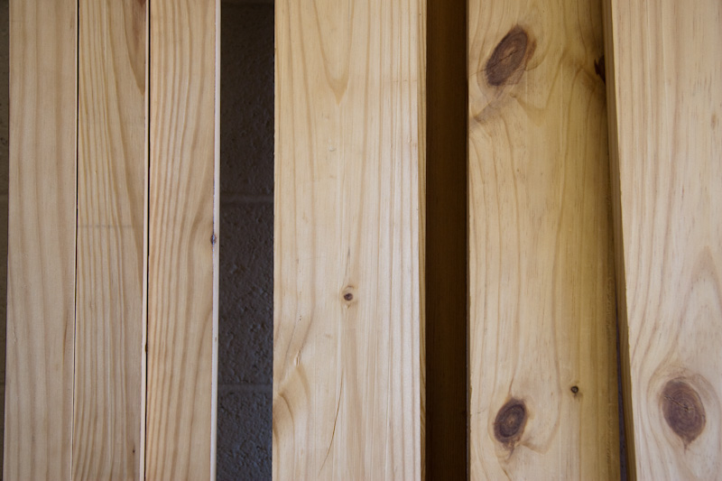

    I have some pine that I salvaged from some old furniture over a year ago and wondered if it may be SYP. Is there an easy way to tell? whatever it is its well aged and pretty hard (for pine) and was considering it for some projects.
    It does have some knots and most of the SYP I have seen seems to be clear. I will try and take some pics later today.

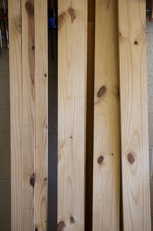

      Here are some pics.
      As I am in the process of re-thinking my work and assembly surfaces I am considering building a new bench in addition to an assembly table.
      I was looking through my stock to see if I had anything that might work. I have approx 30 bd ft of this. If it is SYP it might be a candidate although a lot of it is quite knotty as you can see.
      I also have some Ash, Alder & Birch. Not sure if I have quite enough of any one to make a whole bench.
      Anyway do we think this is SYP?
        It looks like it is a specie of SYP, as there are many species of the "Pines". Your picture doesn't represent the common brownish, amber tones you might see from some species of SYP, but that doesn't preclude that selection from being SYP. If it's hard and heavy, most likely.

          Thanks CMan, The pics dont seem to show the color properly they really are more yellowish, these pics make them look rather brown.

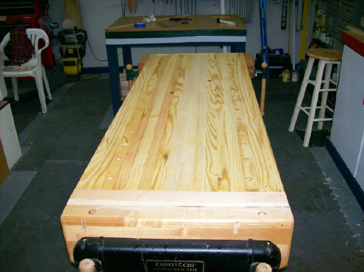

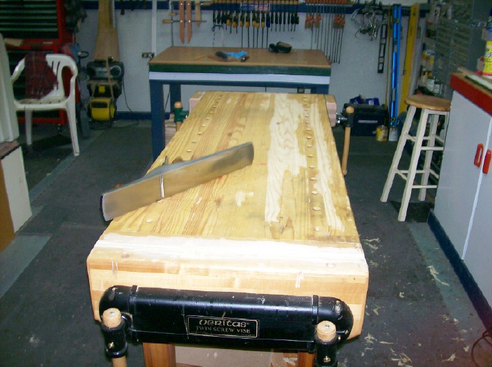

              If indeed the streaks of color are yellowish.. it is likely SYP. And it can have knots. It can and will get extremely hard when it case hardens as I have seen some building timbers from old homes that basically required a pilot hole to sink a nail in. I have used SYP on the last 5 work-bench tops with great success but I use 2 x 12 or 2 x 10 ripping off the outside and throwing away the pith in the center. By doing that it leaves quarter sawn stock with vertical ring lines that look like /////. Most 2 x 8-10-12 will have the pith near center. Then face glueing the 3" wide pieces forming a 3" thick work-top.
              Here's a picture of how much had to be taken off a 14 month old top. Not much as the highest point was around .030. Took around 10 minutes with a #7 jointer.. light sand with ROS and added another coat of Danish oil which gives it even a more amber or yellowish tint. BTW.. the three center pieces are Eastern white pine I had left from several years ago to keep the cost down. The cost to build on this top was around $22.

                      Thanks guys for all the great replies. Judging from your inputs I think that it is SYP (or close variant). Unfortunatley looking at the end grain a lot of it appears to have come from the center or close to it so with that plus the knots I doubt I could yield enough for a top but may have enough to build a base.
