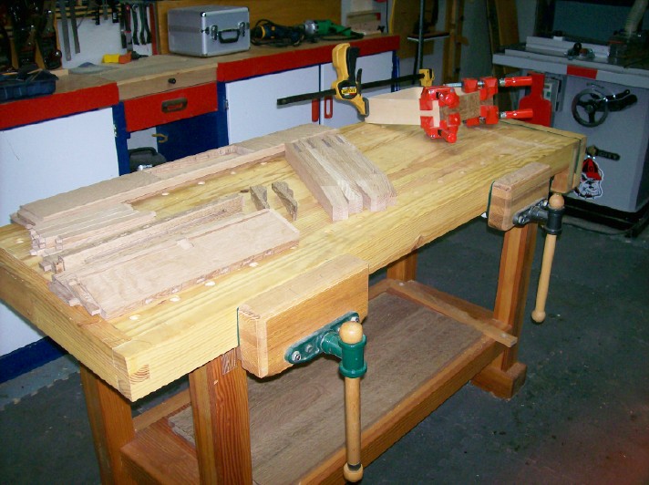

    My bench top is 2 layer 3/4" Southern Yellow Pine. It has worked fine for me for years... It does dent pretty easily, but unless you are going fancy with your workbench, who cares?
      If its free why not. I've run across some pines (SYP), that are pretty darn hard. White pines are much softer. How hard should a work bench top be is a loaded question. A softer top may be more forgiving to your workpieces. A flat surface, and a sturdy bench might be more important than how hard the surface is. You can't beat the materials cost.
        I've built 24 over the last 37 years... some for me.. for sale.. for friends at material cost. The last 6 have been the same using SYP as the top and Doug Fir base. The cost of my current top was around $27 (6 months ago) and 8 hours of build time. I will probably never build another out of anything else.
