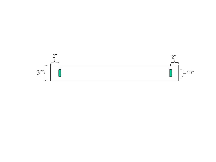

          I didn't make my post very clear, the board is 3" wide and I need to rout a slot so that I have 1 1/2" adjustment, the slots are 2" from both ends.

                It sounds like this is the idea.

                You'll want a plunge router with an edge guide. Use a straight bit, the diameter of which equals the width of the slot. Stand with the long part of the board to your left, and the end into which you are cutting the slot on your right.
                Set the edge guide so that the bit is the correct distance from the end of the board (2", either centered on the bit or from the edge of the bit to the end of the board, as you desire). Position the bit over one end of the slot, plunge the router part way into the board (<1/4"). Move the router until the bit reaches the other end of the slot. Lift the router and move it back to the start of the slot. Plunge the bit again, up to 1/4" deeper than the first time. Rinse and repeat until you have cut through the board.
                Repeat for the other end, following the same rules for board to the left and slot-end to the right.
                IMPORTANT: You will want a sacrificial piece of wood below where you are cutting, for two reasons. 1. It will save your workbench . 2. It will keep the back side of your slot from tearing out the wood of your board.
                Depending on how critical the 1.5" length of the slot is, you might consider setting up stops of some kind, limiting the travel of the router along the length of the slot. This would make sure that each cut would start and stop in exactly the same place. If this is for a shop jig, or some other incosequential purpose, just mark the ends of the slot with a pencil and eyeball the bit as you plunge it in. Even if the purpose is fine woodworking, you could eyeball the whole procedure, leaving the interim cuts just short of the line. Then at the end you could carefully move the bit right up to the line.

                    JR is right about what I want to do. I wasn't sure if I could go across grain with the board being so narrow. Thanks for all the replies.

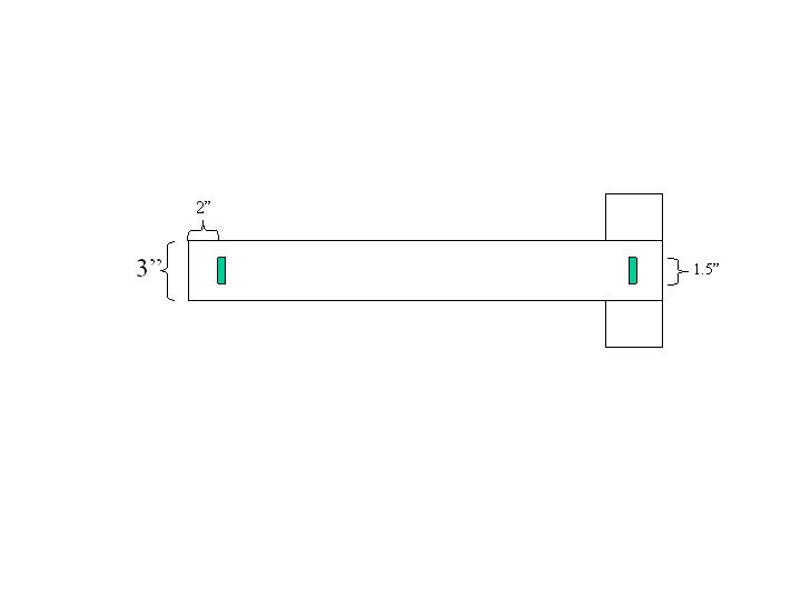

                      If the router seems a little "tippsy" on the edge guide you could clamp a couple of scrap pieces of wood onto the sides of the board. In this way, the end of the board could be made to have a longer edge, making it steadier.
