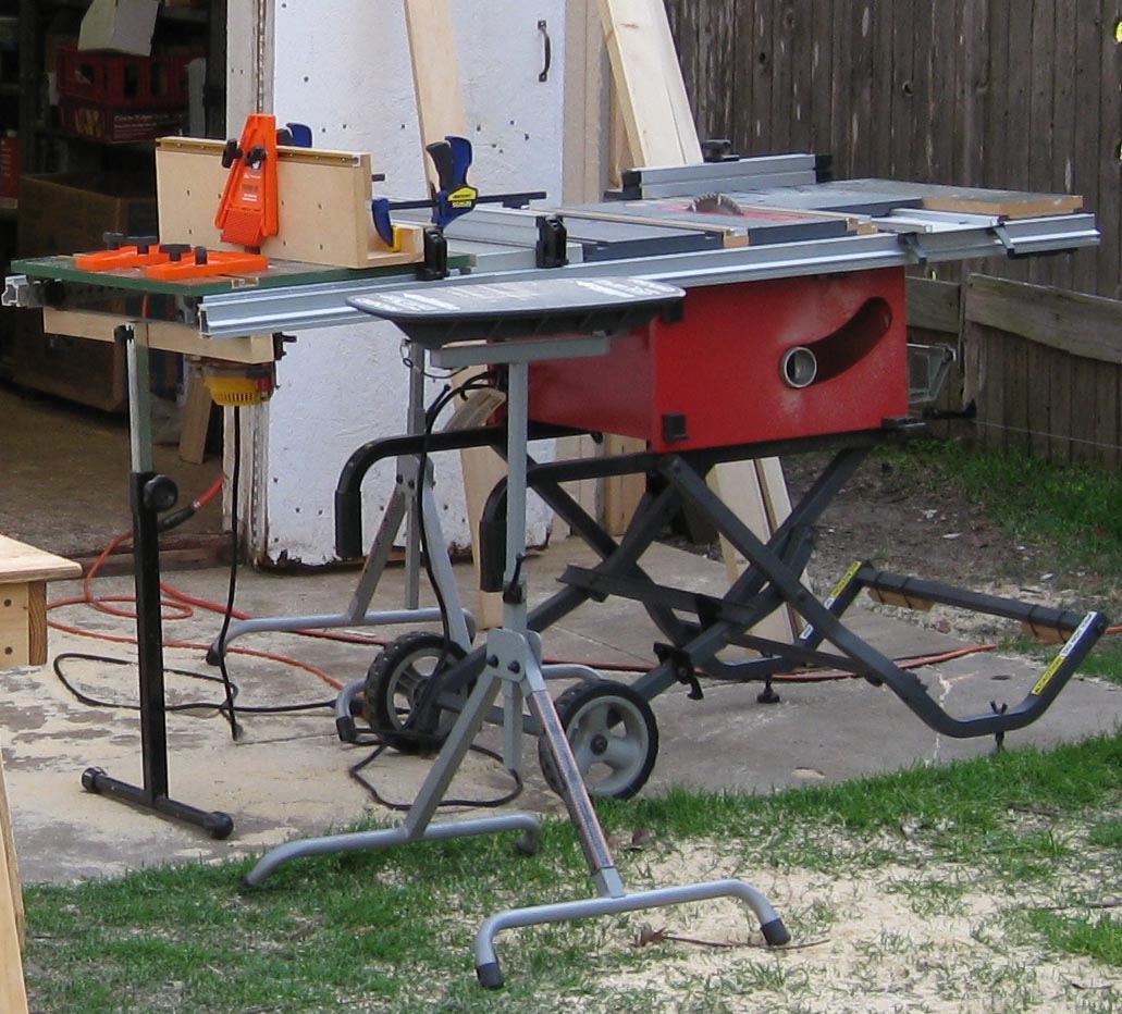

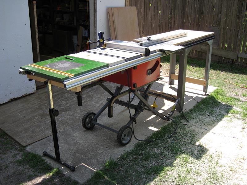

    You don't say if you are going to use a router lift of any kind or even a router mounted in a plunge base. If these are options, why not mount the router table between the rails at a height that would allow the fence to move over it. See the attached photos as one example.
    I used 3/4 inch plastic top (Sanatech), supported by a 3/4 inch MDF subtable with aluminum cross piece stiffeners. It is held in place with oak or MDF mounting blocks (to the rails) and its center is supported the dust collection box.
    This has worked quite well for me. The only issue I have had with this that IMO it would be better of I had a larger surface area for a table top.
    Good luck, Steve

      If you could do your routing off the end of the extension table, rather than the front, then you would not need to devise a new fence system parallel to the table, but just use a clamp-on aux fence on the stock BT extrusion. That's how mine is set up. (I actually picked up a second BT fence, and made my aux. fence permanent.)

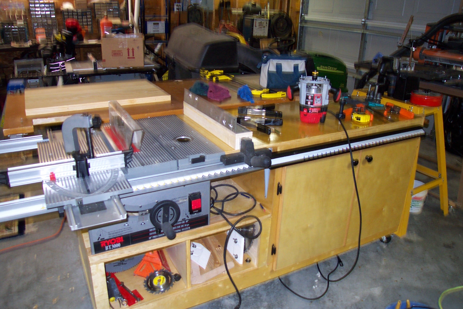

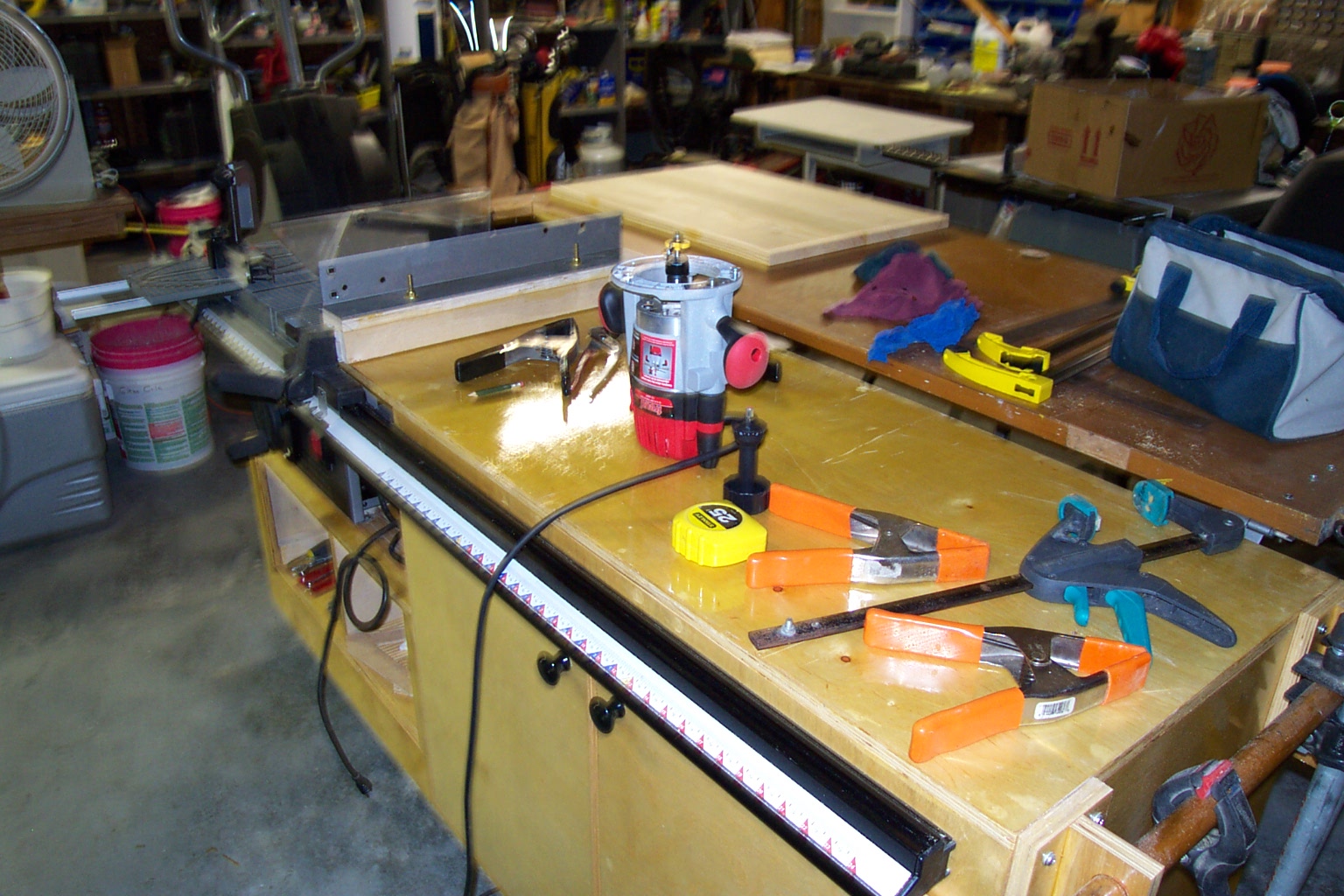

            I've got my router table built onto my saw incorporating a set of half rails. My router fence clamps onto my saw fence. I picked up another fence so I wouldn't have to take down the router setup if I needed to use my fence for the saw. The further you can get the router from the saw the better.
            The only thing I really don't like about working from the end is that there really isn't a lot of space between the rails. Meaning that the table isn't all that wide. Routing long pieces can be troublesome at times.
                  Wow - interesting. I also have the 21829. I don't want to hijack the thread, but I'd love to see more detail on how you added, the 1/2 rails and how the router table mounts. Do you still store the saw upright? If so, how long to assemble/breakdown?
                  Doug Kerfoot
                  KeyLlama.com
                    Doug, there's some more info in post 7 of this thread; http://www.bt3central.com/showthread.php?t=37992
