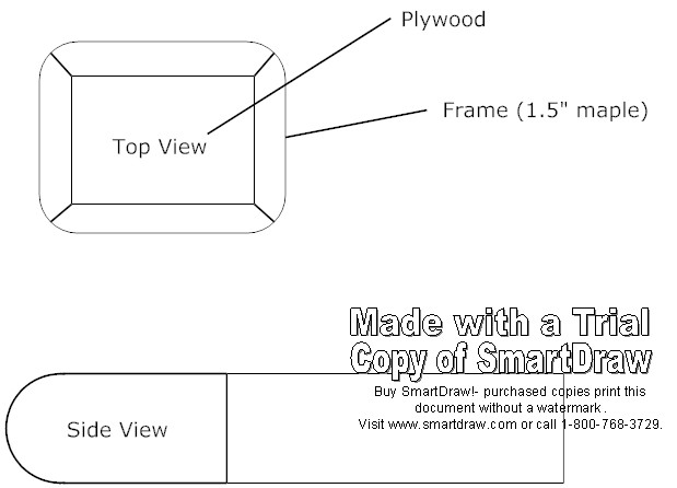

          Should have make it a bit clearer. What I am thinking is that I would like to round two of the four corners. Then, I also need to make the edge with a round profile. I am not sure if veneer would work. I might need to draw a picture to show it better.

                Here's what I am thinking (see attached jpg). My worry is the the rounded corner on the frame would not look good with the straight corner of the plywood.

                  Clear as a bell!
                  No, the rounded corners are not going to look bad against the squqre corners of the plywood. Use maple plywood and it will just all blend together when you finish it.
                  Now, rounding those corners may be a challenge, depending on the radius you want. There are probably a bunch of different ways to approach the problem. Here's how I'd do it.
                  1. Assemble the tabletop, making the corners square.
                  2. Rough cut the corners using a bandsaw or jigsaw. Make sure your cuts are bold of the line you want in the finished product.
                  3. Create a template in the exact shape of the rounded corner.
                  4. Use carpet tape to stick the template to the assembled table top.
                  5. Use a pattern bit in a router to follow the shape of the template, finisihing the shape of the corner. If your template represents just one corner, you'll need to move it to each of thee other three corners.
                  6. Use a bullnose bit all around to get that edge profile you drew. This can also be done by using a roundover bit around the top, then once again around the underside of the tabletop.
                  HTH,
                    If you don't want to do the router/template method, you could mount the edge band (1.5"), draw the radius for the curve...that will be 1.5" also if you want the width to follow around the top. Then jigsaw the curve close to the line. Then use a belt sander, or a block sander and smooth out the curve to the line.
                    Then use your round over (radius bit) to do the bullnose.
