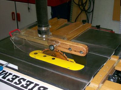

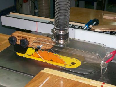

                            BTW... I recieved the piece of metal plate you sent me. Excellent machining as I expected it would be. And.... what is the small hoke bottom right facing the plate behind the U slot? I'm not sure what it's intended for but I drilled larger and inserted a stainless steel pin with ring pull like on a hand grenade. To lift the plate from the slot requires pulling the pin.
                            It all came out superb as your slots at the bottom was a perfect mate to my Uni-saw. I drilled the top to accept my own gaurd and shield. Again supreme machine work on your part.

                              Thanks Sarge.
                              I used the same finish on both. Just wiped on multiple coats of the Formby's poly mix.
                              Light sand between each.
                              Can you send me a picture of the little pull ring thing you mention?
                              The small hole that was there was simply for powder coating. It has to hang in an oven.
