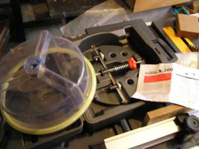

        Those adjustable hole cutters with the cutting blade on an arm might actually work better on the plex than a saw blade. They're not too expensive and might be worth trying just to see what you get for results.

                  I'd use one of those adjustable-diameter circle cutters. Cut the inside circle, then cut the outside circle, out pops the washer.

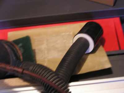

                      Use the drill press and the circle cutter. It is easier to cut the small hole first. Adapter for dust collection.
