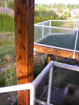

                  TK Western Cedar with 2 coats Penofin after 2 winters, 1 1/2 summers

                      You are right. I had better slap another coat on this summer.
