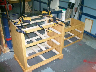

        Had to sit down and calculate an after the fact plan to tie the top and bottom chest to-gether as this is a first atttempt for me. Basically just an idea scribbled on a note-pad without major detail. Winging the tie-together so to speak. Perhapsnot the best approach.. but I felt comfortable I could before beggining.
        But.. a very important step in my mind as I think it will define the difference between catching an eye or just being two boxes sitting on top of each other. The belt so to speak must blend the base and top treatment into one flow or the whole thing goes out of proportion I feel. I will find out soon.
        Tie in with a false top between top and bottom begins after an hour of personal debate on how. And Danish oil gets laid to wait for the cure before final finish can proceed. A game of patience at this point as you want to rush to be done but... knowing that could lead to a booby trap exploding in your face.

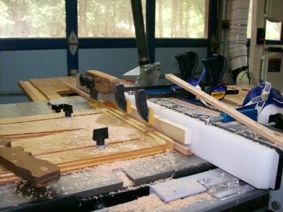

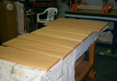

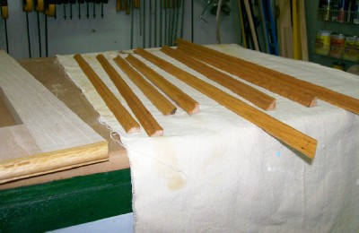

          Minor details have been attended to as I wait. Moulding has been made by either machine or hand profile scrapers or a combination of both. Ripping 5/8" moulding strips on a TS can be a dangerous challenge if you don't take safety precautions. But... once you do you can rip down to 3/8" IMO using a thin push stick without your hands coming closer than 10" to the blade.
          Moulding cut and base Danish coat added. Drawer fronts have to be drilled to accept knobs. Other than that.. just a wait for Danish cure before the first coats of shellac can be padded on. Three to 5 coat of that and then another wait until it cures for the final rub-out and wax.

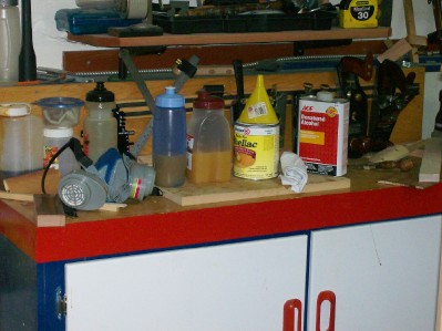

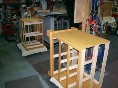

              I had some nifty picture once, Crash. New paint.. everything spot-less and in it's right-ful place. Once you get the pictures you jump in feet first and get it dirty. I have to take the over-head guard off to run those narrow strips. The cyclone force from below won't get what goes up so you end up with a mess without that over-head.
              The good news is all my large machines are around a cyclone in the forward area near the double doors. I call it the "cut area" and even the machines in the rear shop get rolled up quickly to the "cut area" to make saw-dust. About every three hours I put on a dust mask.. hook up a 140 mph electric leaf blower.. open both doors and start in the back of the shop with a major "blow-out". Then the over-head air filter system is turned on and I go up for a 30 minute coffee break.
              That is fine saw-dust you see and needs to be removed often. You can hand plane 1/8" off several 4"-8' boards and have .002 shaving accumulate up to your ankles. It's amazing what happens to those thin shaving as they de-compress coming off a plane iron. From the looks of all the shaving you would think several hundred board feet got planed.
              Oh well.. if you spend 6-10 hours a day in the shop as I do currently... you are going to have dust and shaving. If you don't.. you are probably napping and not getting anything done.

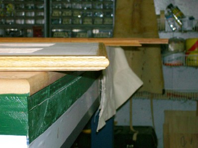

                  Molding has been attached... knobs on drawer fronts attached.. bottom and top chest united.. rear dust shield cut, shellaced and installed. A coat of Liberon Black Bison wax was applied with Liberon 0000 steel wool and buffed out.
                  Using the steel wool to apply wax acts as a final rub-out to take the sheen down a notch from shellac's gloss to semi-gloss saving a step. Full gloss would not be appropriate for the style. Basically a simple, functional design and really just one box on top of another box with drawers.
                  Take a little here and add a little there to attempt to make it as one and take off the rough edges. Heat has been horific for about a week and a half. Dehydration was starting to set in so a rest is due as the finish line has been finally reached. The wax has to cure a few days but on the 36th day just before mid-nite the journey has come to an end. No more steps to take as the chest just awaits the wax to cure and it becomes functional and is signed.. sealed and delivered.
