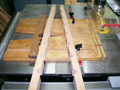

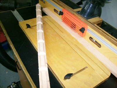

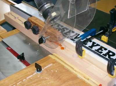

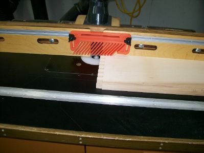

      I can't really tell from the pics, but is your boxjoint jig set up for dedicated 3/8" wide pins with your Frued blades, or is it adjustable? Do you go back and glue in a plug where the dado removed part of a pin?
      Working with basswood is what got me into this hobby. We made a bunch architectural models in college out of basswood. I still like working with it on smaller projects (and I still have a bunch of thin stock to use up too).
      The jig is made to take a 1/4" guidepin.. 3/8".. and a 1/2" I believe without going to look. They come with it as I think I purchased it from Eagle America several years ago under the name "Mighty Jig". They are simply inter-changed with one screw that sits in a slot at the base of the face frame.
      The Freud Box joint set will do an exact 1/4" or 3/8" by the way you face the writing. Writing out.. 1/4".... wriiting in 3/8" and I mean exact as I mic'ed them. Flat teeth which leaves an perfectly smooth bottom and the blade are the silver ice coat. Just keep the pitch cleaned off and you don't have to touch up the joint at all.

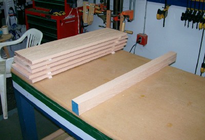

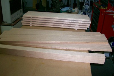

      I choose the basswood to try is it is almost crystal clear as soft maple but much cheaper here in Atlanta. Soft and measure have to be taken to avoid any splinter. But so far.. a pleasure to work with keeping that in mind.
        Late start as I had forgotten to puchase 1/4" ply for drawer bottoms. A trip to my hardwood supplier about 13 miles away for one full sheet of birch as it was exceptional. A new load of hickory was coming in tomorrow but I chose to go with the birch as it was there today and save gas.
        But.. almost drought here in Atlanta again but a sudden afternoon thunder-storm popped up so I had to wait an hour before leaving. The bologna sandwich and cat-nap was good while waiting out the rain as the ply was exposed in the rear of the truck. We need the rain desperately.. but my luck it came when it did.

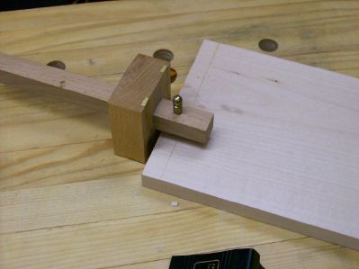

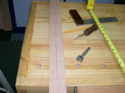

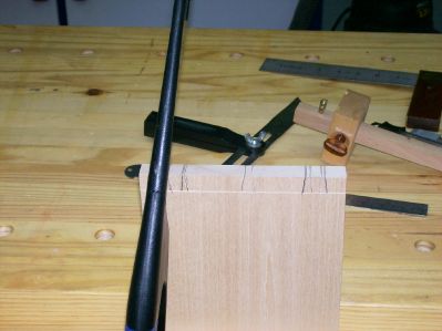

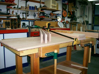

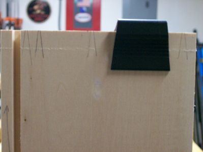

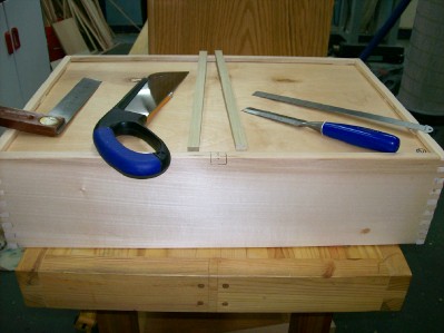

        Tails first in my shop to mark pins with. 5/8" thick drawer sides so the marking gauge gets the call for 19/32" to allow the compression of the back of the chisel to take the extra 1/32" without over compression in a final chisel chop out. Then mark the tails by eye as is my preference being careful to stay somewhat random as my nature if to see symetric. Hand cut DT's are a "signature joint and they should appear random.

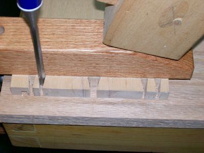

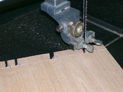

        Clamp and cut with special attention to the initial entry as the first 3 pulls with my cheap Irwin pull saw will define the course of the remaining cut to the depth line. I use a fan blowing on the work to keep the kerf visible and to move the fine dust created away from me breathing it.

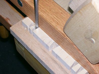

        The saw has done it's work and time to clean out the major waste between the kerfs. I was taught by Ian Kirby to use a coping saw.. a coping saw does not agree with my haste to take out the major waste. I call on my smaller 12 Jet band-saw to do that job. Total concentration and a steady guide hand is required as the 1/4" 6 skip tooth will make a mess with the slightest slip or loss of concentration.

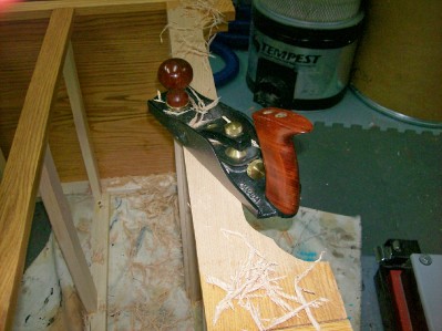

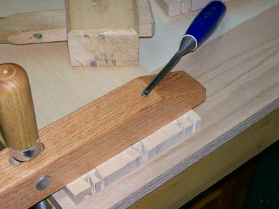

        The final chop of the rear line it taken back to the bench and the depth line is clamped down on a backing board. I use a wooden jawed clamp and the side of the jaw becomes my 90* guide on the final chop with the Marples "blue beaters". Any in-significant waste will be paired with my skew chisels..
        Cut the remaining set of tails and move on to mark the pins with the existing tails... Another day.. another step as I will finish the tails to-night or tomorrow. I never get in a hurry cutting DT's as it can be fatal to the result and a large loss of time.

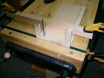

          The pins have been done at this point using the existing tails laid over the stock to be pinned as a template. I vertically stand the pin board between my twin screw vise and lay the tail board on top. But.. I use a piece of scrap on the border of the tail board to keep the pin board exactly on top of the tail board.. then clamp the whole thing from over-head.
          I do not want either to slip the slightest as one slip means a bad fit or start from scratch if severe enough. It is important that I properly marked left-right and oriented the side with tails to the proper adjoining pin board. Another case of if you lose concentration and orient in-correctly... not good news. I use an Exactor knife as it cuts very fine and can be held well to the inner tail walls. Just my preference as any good marking knife will work fine.

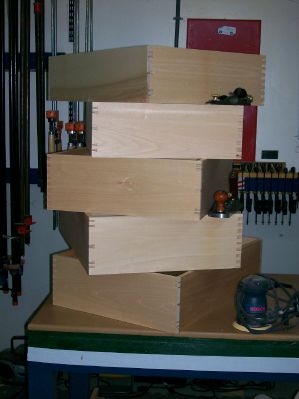

          No glue at this point even the joints will hold it together. It's time to cut the drawer bottoms exact to fit there 1/4" by 1/4" slot in the base of the inside drawer components. Then two coats of shellac both sides to the bottoms. I want to seal the ply as I nor anyone knows if formaldehyde was used in the glue. Better safe than sorry.. so we seal with shellac.

            Drawer bottoms were cut for both the top and bottom drawers. I wet both sides lightly with distilled water to raise the grain. Distilled has the minerals removed in the distilling and removes the chance that minerals will inter-act with tannins.. etc. in the wood to latter show as various spots appearing through the finish.
            Sanded the raised grain to 220 grit to remove the fuzz before application of two coats of shellac padded on each side to give the ply bottom a hint of amber but mainly to seal off any un-wanted vapors from glue components in the ply.

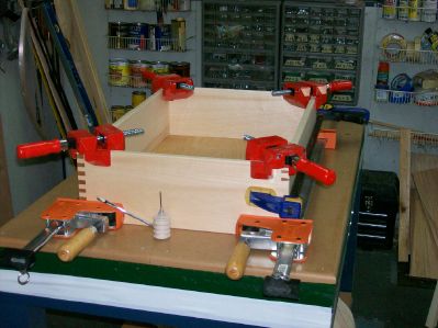

            Round over the edges for drawer sides and touch the end grain with a light gel stain to accent the exposed joints. The drarwer are now ready for glue-up and final prep to add drawer fronts and knobs. Two have been glued and the remaining 3 won't be until Wednesday as I have to drive my wife for an epidural for a degenerating disc tommorrow early. Will like take the remainder of the day off.
            Hot in Georgia but not that bad in the shop as it is partially under-ground with the rear shop being totally under. But with doors open to vent shellac fumes.. the heat and humidity will roll inside in a matter of minutes. Another day.. another step complete.

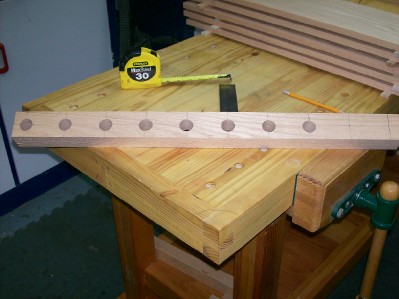

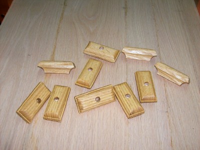

                          Home-made drawer handes take some time as there are several steps I use starting with a single block of wood. Drilling a hole center line along the lengh with a Forstner bit.. then ripping. To the router table for coves on both sides. Then round over the tops. Cross-cut to get the individual handles and then round over the ends.

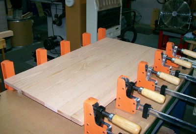

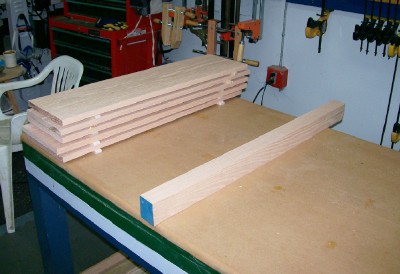

                          Drawer faces have to be cut down to actual size and then a round-over or whatever method you chose on the edge. The same with the top after it comes out of the clamps. Cut down to size.. plane any ridges.. treat the edges. Same with the base runners which have the additional step of cutting a pattern using a MDF template and an over-head bearing pattern bit after cutting to 1 mm of the actual line for the pattern.
                          Then all has to be sanded and the grain raised with distilled water before the final grit. At that point I can apply a coat of Watco Danish and let it cure before it get any shellac. Details.. details.. details.... Wood-working is full of detail.

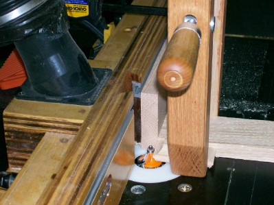

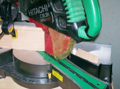

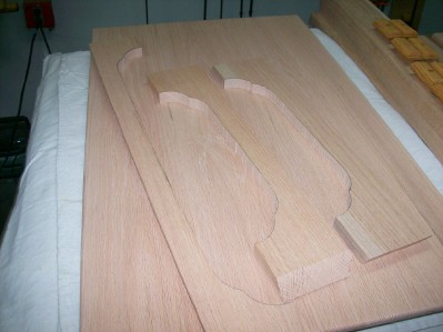

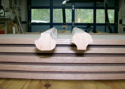

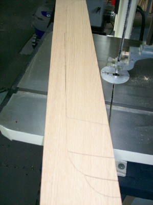

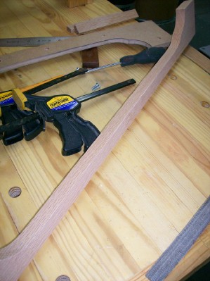

                              ROS and hand profike sanding until mid-nite last night. Today the base-boards got attention with cutting to length with miter cuts on the corners before the curve was added. But.. a discovery that the bottom side to side runner had bowed out 1/8' in the center and tapered out to 1/32" bow out on the ends. Several simple passes with an LV low angle smoother took care of that. Sand down and add more Danish oil there.

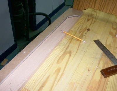

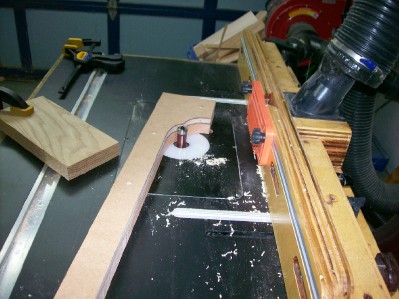

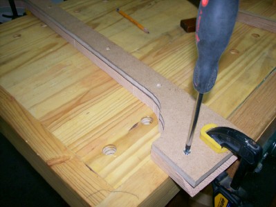

                              The curves... normally takes some time to build an MDF template from 1/2", but it was already built for the 6 drawer chest and TV stand that match. So.. use the template to draw the curve. Take it to the BS to cut to within 1 mm of the actual line with relief cuts coming before the main cut. Once the stock has been cleared to 1 mm I attach the templates on the back sides with screws as that side won't be seen. If it were double side tape gets the call.
                              Once attached... one simple pass on the router talbe with an over-head bearing pattern cutting bit with the bearing riding on the template leave a perfectly smooth.. exact curve as it followed the template. The template takes time to build.. but once done hundreds of duplicates can be made very quickly depending on how steady you are with a band-saw. The OV bearing takes care of that step with very little chance of a foul-up.
