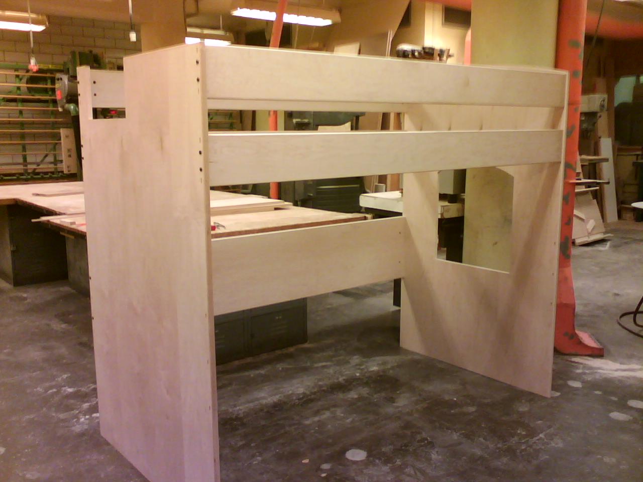

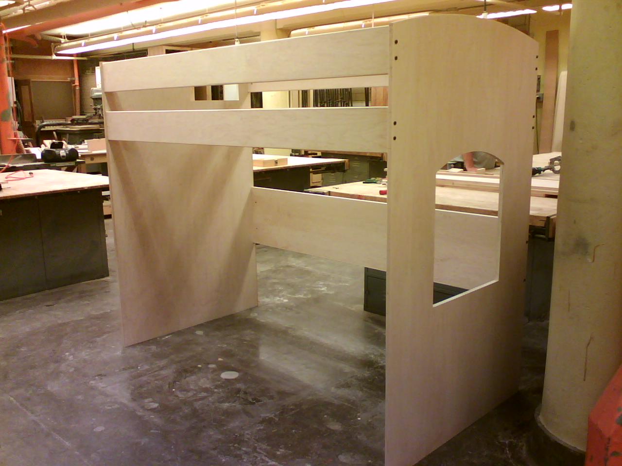

    I've been in the process of making a loft bed for my son and realized that wiping on stain and varnish may not be feasible on such a large project. So, I recently purchased a HF HVLP sprayer and would like to use it on the bed. I posted several pictures of the project along with a screen shot of what the stairs look like. What's missing is the four stairs that will lead up to the bed and placed on the side without the window cutout. Each step will have a drawer inside that is not made yet. The design is from a bed I saw at USA baby. I didn't think their price of $1500 for a bed made out of paper veneer pressboard was nice enough. This one is made from maple veneer plywood with 1/4" solid maple banding.
    The only place at home that I have to work for spraying is a small garage or driveway. It was suggested to me that I should spray the bed in pieces as opposed to set up. The bed is put together using cross dowels. I made a bookcase previously and stained it with a General Finish maple stain to bring out some color and then used GF oil/varnish to topcoat. I'd like the bed to match so my thought was to spray the GF stain and then spray a finish. The topcoat I'm open to suggestions. Any suggestions from people that have sprayed stain and lacquer/varnish would be appreciated. If you have the HF HVLP sprayer all the better.
    Thanks in advance. And no, the room the photos were taken in were not my shop. I take an evening class at the local technical college.

      I guess my thought is, "look at the size of that shop!"
