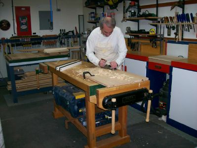

                  I have made one from red and one from white oak, Jon. Worked fine and all are still in use in others shops. I have made two of Hickory and one of ash. Both worked fine and still in use in others shops. I have made several from laminated ply with a hard-board top as I just gave one to Thyman from this forum Monday. I have made 4 from Southern Yellow pine and the same scenario.

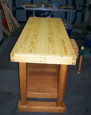

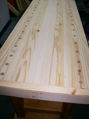

                  I built a new top for myself three weeks ago. Purchased the stock on Friday morning and transferred vises the following Monday. It is Southern Yellow Pine and cost around $25 with a bottle of new glue. I use Doug fir for bases and they work fine also. When I build a bench, I always make the top 3" thick by face glueing as that is my intention. I want weight as I use gravity and a bullet shaped dowel on top of the 4 legs to hold it down. Two people can lift them off in seconds to move.. or adjust vises.. etc.
                  Work-benchs can be made from about any wood and be sucessful, IMO. They should be jointed well to resist rack if you hand-plane. If you put scars on top as I do (I often just nail a batten down to use as a stop).. you can fill them with wood filler or bondo and sand it it you prefer no un-sightly holes. But... work-benches should be made for work and not dining. They are blue collar producing for white collar.

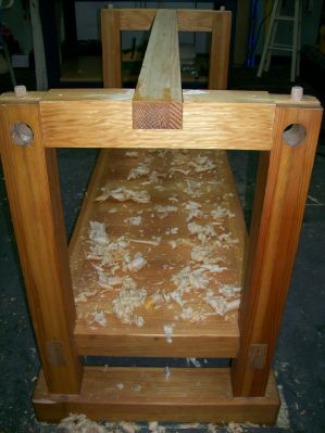

                    Sarge, looking at the picture of the end without the top attached what are the holes just below the dowel pins? Secondly, I believe that you're taking lessons from Rod on shop cleanliness and order!
                      I thought the same thing, I think they are to do with the end vise - Sarge?

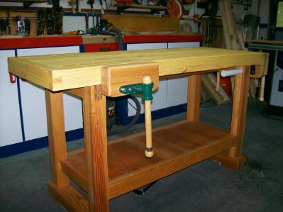

                        Thanks Sarge, thats what I love about this forum, so much real life expereince. I am very jealous of you and other folks who can have a bench permanently set in the middle of their workspace. All my benches and tools need to be moveable.
                        I love the simplicity of your bench design. looks strong and most important highly functional. My biggest concern is that the construction of the simple frame on my current bench wont easily come apart and that I could end up having to make a whole new bench. Definatley a project for the future but I have too many already in the pipe.

                          Chiz, the holes are for the twin screws of Sarge's end vise to slide through.
                            LV twin screw would be correct, Chiz. Which I love BTW. I can clamp a panel between the screws and hand cut dove-tails just to mention one advantage of it. The draw-back to that vise is it cost more than the entire bench by far as the Douf fir I used for that base was originally a single beam several hundred years old that I recovered for "free" when they tore down a civil war ware-house by the railroad yards here in Atlanta.
                            I had ripping it into 4/4 to use and then decided to re-laminate it to get the 3 3/4" squares for the legs. Once that one was built.. Doug fir became my base material on all benches I make. I usually make one every summer to sale or for a friend at cost during the humid months here in Atlanta. I may not this year as my wife has me busy on an entire bed-room suite (bed and one chest of drawers complete since Oct.) and I am snowed under.

                              Hey Sarge, nice curls! I love the shavings from a well-tuned plane.
