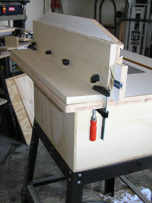

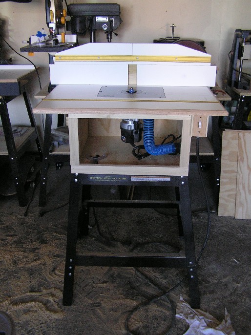

    Almost done with this project. Still need to fab a frame&panel door for the front.
    Mentioned in another thread I was going to need this table to use my raised panel bits that won't fit in my BT3 accessory table.
    Made almost entirely of leftovers. Melamine top (30x24) from a sheet used for several other projects; box/housing for router from plywood sheet scraps; melamine and poplar for fence also scraps; oak edgebanding on table leftover from toybox project.
    New items included:
    $19 HF universal tool stand (claims a 500lb capacity)

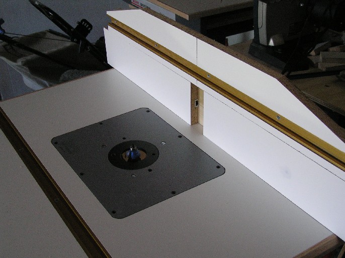

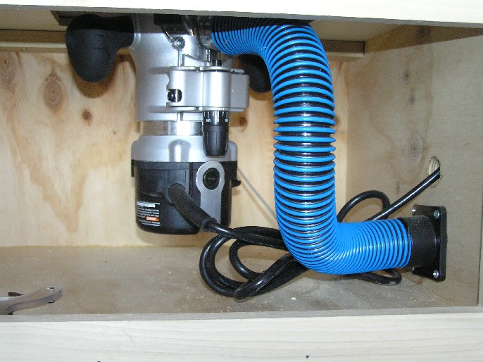

    $49 for the precut phenolic router plate (with inserts) - has a 3.5in throat, so I don't even need to lift the router/plate combo out to change bits
    ~$30 in T-slot and miter track for table and fence
    $3 in "pool hose" for connecting router DC port to external DC (shopvac) port
    $15 in electrical parts for switch/outlet box.
    So all told, less that $130 in materials.
    Tabletop patterned after Rockler tabletop, fence patterned on combo of Rockler fence and Norm's router table fence. Not fancy, but functional - ran some test pieces on it, and am happy with its performance so far.

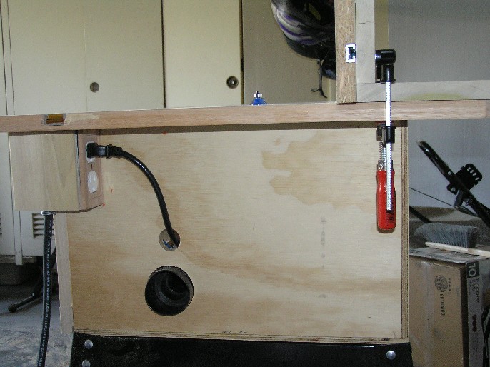

    Since I use my shopvac for DC, I decided to try an idea inspired by my neighbor, the furniture maker, who showed me an ad for an outlet to power both the tool and the DC. I took two single-gang boxes, mounted them back to back, put a switch in the front side and wired it to the double-outlet mounted into the back side. 20A/120V parts with 12g wiring and cord.

    Very nice indeed, looks very solid I am sure it will serve you well. Did you make some shims for the outfeed fence for jointing or do you have a standalone jointer?

          Nice. Mine has a similar switch setup except I put the outlet next to the switch (on the outside). I run the router cord out and plug it into the switched outlet. You can get metal cover plates for a metal box with one side a switch and the other an outlet. The only advantage is it lets you easily unplug the router when chaning bits. I find a 20A outlet and switch hold up nicely and cost a lot less than the stuff they sell for router table switches (including the one Norm used).
