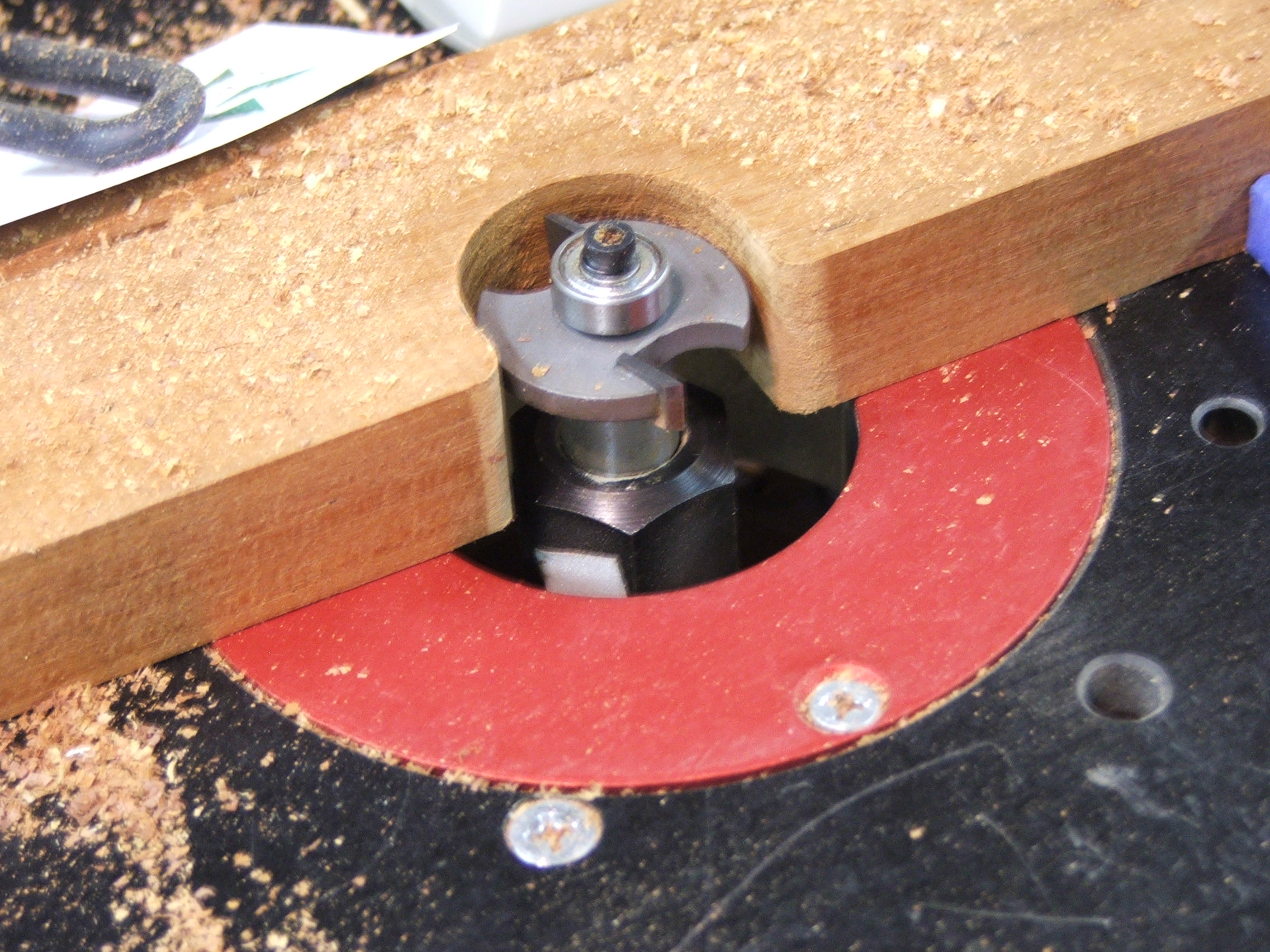

              here's my current router fence. Nothing fancy as you can see. Just a planed and jointed hardwood (Jatoba, I think) board, two quickgrip clamps (one at each end), and a offset hole drilled near the center. A hole at one end to hang it.
              I think it works fine, until I need a better fence, then I have the Incra 16 which needs unpacking.
