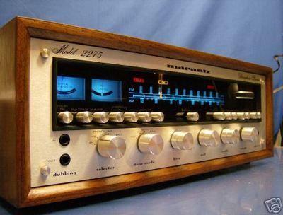

              hey if its that great, then you should just get some real solid walnut and make a cabinet in the original style but out of solid walnut!
              Keep the original classic look and appeal but make it out of better materials to last another 50 years.
              The old Marantz classics of the 60's and 70's had optional walnut surround enclosures, rabetted for the panel faces and chamfered on the inside edges for an elegant look... not easy to do the chamfer handsomely on laminates and ply. For the Marantz collectors, a wood cabinet in excellent shape is highly prized.
              here's some pround owners' photo of a Marantz in a WC22 walnut cabinet, probably dates to the early-mid 70's:
              http://sportsbil.com/stereo/mrntz_2285b/
              Here's an attached pic of another:
                When I saw this, I immediately thought of walnut-veneer ply. Good dimensional stability in all directions, and you can finish it beautifully.
                  As I previously suggested a hardwood plywood is your best bet. If you want some sort of detailed edge, cut the plywood in running lengths, and add a solid wood edge. Then do whatever machining to the lengths. When you cut the sides and top and bottom, it would be like working with solid wood. You could do a mitered corner or lock miter, for the joinery.
                    Thanks Loring. That looks very much like the old enclosure.
