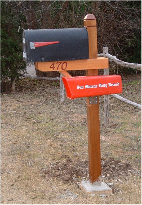

                  Nowhere near the amount you are talking about, but these were done by hand following a pattern glued to the wood.

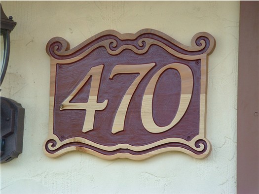

                  The main things are to glue the pattern down completely and take your time with SHALLOW passes.

                        Any size letters and any font you like can be printed from a computer on heavy paper and then sprayed with adhesive and used for a pattern like a stencil.
