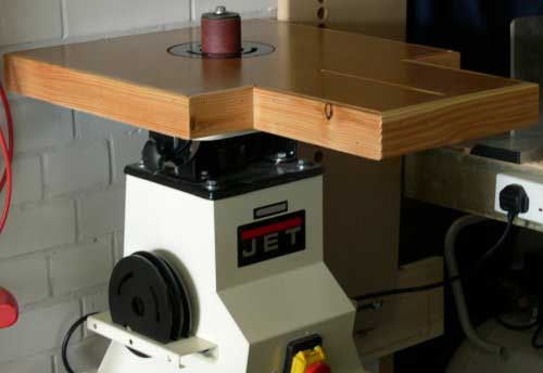

                      MDF is, as you say, easily gouged. If the surface was hard-glazed, it would fracture, whereas with Tung oil, it won't - and repairs are easy. Because it's an oil, it will waterproof the surface to some extent and also put a sheen on it, enabling you to slide stuff around easier than on "raw" MDF.
                      The method of application is important to get right. Spread, brush, or rub on a thin coat, leave 15 - 20 minutes, then remove all excess oil. Repeat until you're happy with it. Here's an example of the finish on a mod I did for my Jet OSS:
                      N.B: If you don't remove the excess, it will be permanently sticky, so don't start this job if there's a chance that you might be interrupted! HTH
