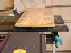

                As mentioned by the other posters, it works. I had a jointer, but no planer for the longest time. I finally got a planer a couple of months ago.
                I made a sled-bed with rails, about 20" by 18", with my router, that was my planer for the longest time. I still use it on occasion when I want to plane something that's too large for my planer, or unpractical, like end-grain cutting boards when my glue-up wasn't spot-on.
                Here's a photo.
                Dust collection sucked (or not, since there was none to speak of), it took much longer than a planer and the results still had to be cleaned up a bit with a scraper, but it came out flat, which was the most important consideration.
